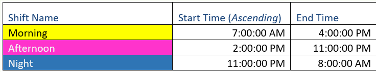

How WFM Tracks Shifts
Although a user could be assigned with a default “shift”, it is not mandatory that the user clocks-in into the same shift. Having said that, WFM determines the shift based on the time that the user clocks into the facility. For example, if there are three shifts configured in WFM:
Depending on the time at which the user clocks into the facility, WFM determines the closest “Start Time” from Shifts and clocks the user against that shift. For example, if a user clocks-in at 6:00 AM, the shift is determined as “Morning”. If a user clocks-in at 8:00 AM, the shift is determined as “Morning”. If a user clocks into the facility at 7 PM, the shift is determined as “Night”, because 7 PM is closest to the “Start Time” of 11:00 PM" in the table above (In other words, 5 hours have already passed since shift “Afternoon” started)
This helps provide a true picture of the shift in which the user worked as well as use shift filters appropriately in all the productivity reports.
