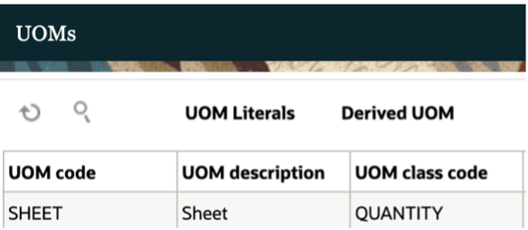

To create derived volume UOM and derived area UOM, Select the ‘Derived UOM’ action button. The following fields are available in the Create/Copy/Edit flow:
  • Dimension UOM
  • Derived Volume UOM
  • Derived Area UOM
Derived UOM
