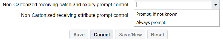

To configure the non-cartonized receiving for batch, expiry and inventory attribute prompt controls:
  1. Go to IbShipmentTypeView screen and click Create button.
  2. Enter the shipment details and populate the desired prompt control:
    • Non-Cartonized receiving batch & expiry prompt control: Blank (Default behavior)/ Prompt, if not known/Always prompt.
    • Non-Cartonized receiving attribute prompt control: Blank (Default behavior)/ Prompt, if not known/Always prompt.
      Note: If the field is set to Blank, the system honors the item level configuration.
      Configuration Fields for Non-Cartonized ASN
  3. Click Save.
    Note: When Non-Cartonized Receiving for Batch number & Expiry Number /Attribute prompt control is set to Prompt, if known or Always prompt, the system does not honor any of the item property configurations for batch/expiry dates/ inventory attribute.

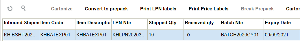

Let’s say, you have the following ASN to be received:
Prompt for batch/expiry date for single SKU for non-cartonized

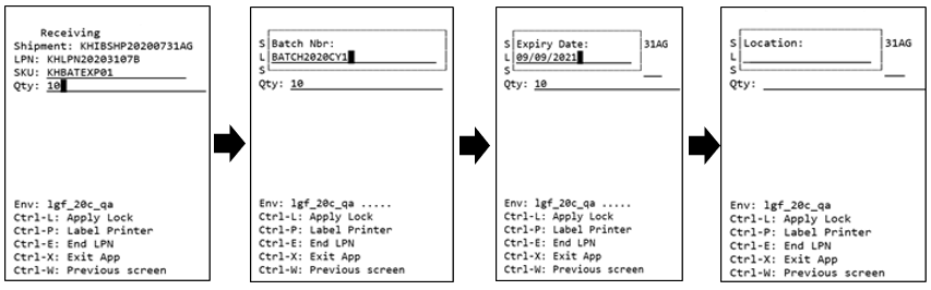

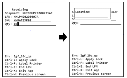

When Non-Cartonized receiving batch/expiry date prompt control = Prompt, if not know:
When Non-Cartonized receiving batch/expiry date prompt control= Always prompt
Note: On scanning an existing batch with batch master populated with an expiry date, the system will not prompt for Expiry date even if the expiry date prompt control is set to Always Prompt (either at item level or shipment type).

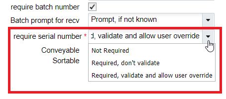

Non-Cartonized Receiving for Serial number prompt control
  1. Go to Item UI > Details. Click Edit.
  2. Enable the “required serial number” drop-down at item’s level configuration with values:

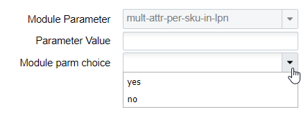

  1. Go to Module > Recv {lpn} Shipment/ Recv {lpn} Load
  2. Select mult-attr-per-sku-in-lpn and click Edit.
  3. Choose the parameter from the drop-down menu:
    • mult-attr-per-sku-in-lpn = Yes : Allows multiple Batch/Expiry/expiry/inventory attribute of the same SKU into a single/multiple IBLPN.
    • mult-attr-per-sku-in-lpn = No: Does not allow multiple Batch/Expiry into a single IBLPN (existing behavior) or during upfront palletization.
  4. Click Save.

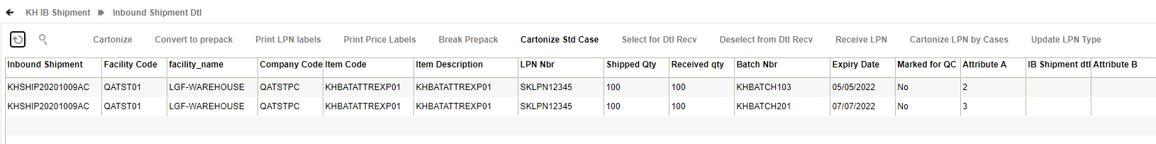

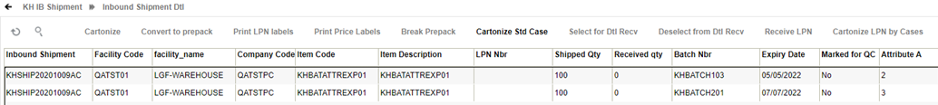

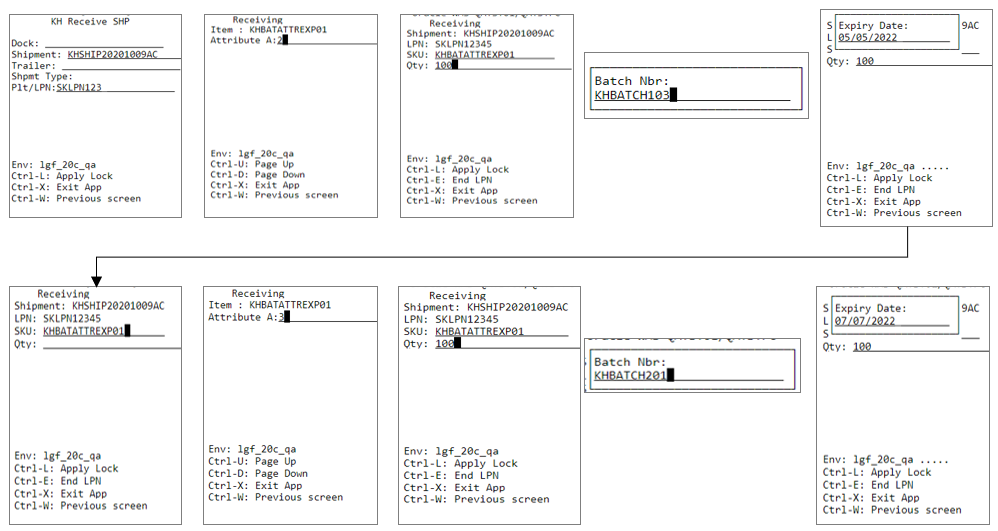

Let’s say you have the following ASN configured:
Receive Multiple batch/expiry/inventory attribute for the same SKU
The system scans through the SKU 1 (attribute, batch and expiry) and without ending the LPN, the system loops through remaining SKUs with the same hierarchy.

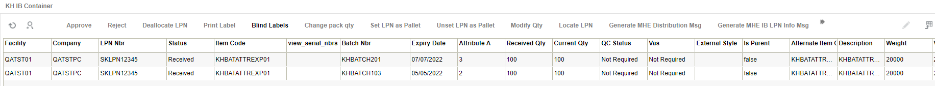

Receive Multiple Inventory
Upon scanning all the SKUs in the LPN and performing CTRL+E, the system receives the SKUS and updates the shipments details in the following manner: Receive Multiple batch/expiry/inventory attribute for the same SKUReceive Multiple batch/expiry/inventory attribute for the same SKU
