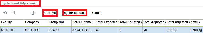

Approving and Rejecting Adjustments in Deferred Mode
The Deferred Mode allows supervisors to approve/reject inventory adjustments made by users who have previously Cycle Counted locations.
Approve and Reject Inventory Adjustments
To approve/reject records, make sure it is in “Pending” status and click the “Approve” or “Reject/Recount” buttons.
Note: The Cycle Count Adjustment Header provides options for both approval and rejection actions. However,if you want to implement unique workflows for approval and rejection, you can enable the following group permissions:
  • To use the Approve action button, enable the group permission “location / Approve CC Adjustments”.
  • To use the Reject and Cancel action buttons, enable the group permission “location / Reject or Cancel CC Adjustments”.
To control the Reject and Cancel action buttons, you must manually enable the group permission “location / Reject or Cancel CC Adjustments”.
Users with the "Administrator" role can Approve and Reject Cycle Count adjustments by default. To grant the group permission “location / Reject or Cancel CC Adjustments” to users with other roles, such as "Management", it must be added to their respective groups.
Approving a record applies the inventory adjustments by adding/subtracting inventory from the locations as well as posting records in the Inventory History screen (referenced by the Group Number).
Rejecting a record will cancel the inventory adjustment and trigger a new CC task so that the location is re-counted.
Note: If the selected record is at the LPN level (field ‘Loc Dtl Count’ <> blank), the system will display an error message “Cannot reject count at the LPN level.”

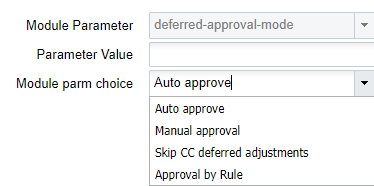

Deferred Approval Mode set up in RF Cycle Count Transactions
Previously, when performing a Cycle Count with RF Cycle Count Location or RF Cycle Count IBLPN, you would use the screen parameter “auto-approve-mode (update 18C).” This screen parameter is now called “deferred-approval-mode.”
The deferred_approval_mode parameter makes it easy for you to distinguish the approval modes available while you are performing cycle counting operations.
From Modules, select Cycle Count Location or Cycle Count IBLPN, then Screens, and Screen Parameters to view and select your module parameter choice.
Deferred Approval Mode Parameter
Note: you still have the option to use Auto-Approve-Mode as old options in this screen parameter are still available.
The available settings for the Deferred-Approval-Mode screen parameter are defined in the following table:
Mode Definition
Manual Approve When "deferred-approval-mode" is set with Manual Approve, "RF Cycle Count Locn/IBLPN" writes the count information in the CC Deferred Adjustment UI and will leave the information for the supervisor to approve or cancel the count if supervisor is logged in with company and facility combination and mode is configured with deferred mode.
Auto Approve When "deferred-approval-mode" is set with Auto Approve, RF Cycle Count Locn/IBLPN" writes the count information in the CC Deferred Adjustment UI and will get Auto Approved after passing through all the validations if user is logged in with a company and facility combination and mode is configured with deferred mode.
Skip CC Deferred Adjustment
  • When "deferred-approval-mode" is set with Skip CC Deferred Adjustment, then while executing "RF Cycle Count Locn/IBLPN"; the system does not write the count information in the CC Deferred Adjustment UI even though the user is logged in with company and facility combination and mode is configured for deferred mode. In this case adjustments will be posted as an immediate counting mode.
  • If there are discrepancies found while counting, when the system is operating in this mode, the necessary inventory adjustments are posted when counting is performed for the location/IBLPN.
Approval by Rule
  • You can define the rules and set the tolerance % or value for an item or group of items. The system will check for rules before writing to the CC Deferred Adjustment UI and wait for approval. See Configuring a Cycle Count Approval Rule (Approval Rule Options) for more details.
