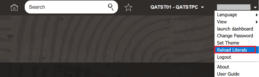

In the company edit pane UI, flag “Reload Literals upon Changing Company” helps you enable reloading of the literals upon changing the company in 3PL scenario. If you have different literals configured by company then enable the flag. A manual option to reload the literals is also available in the settings menu associated with the user.
Reload Literals
Note: After switching companies, literals from current company shows up in the UI if either the from/to company has Reload Literals upon Changing Company set to “yes”.
