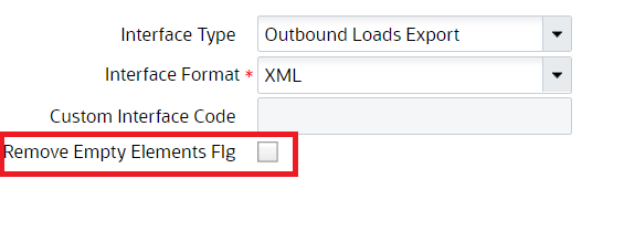

Remove Empty Element Flag
You have the option in Oracle WMS Cloud to share information to external systems through output interfaces (for example, inventory history, shipment confirmation payload). In certain scenarios where some of these output interface payloads is exposed to rest api endpoints, can be pretty huge depending upon the data present or you would not have used all the data elements for the corresponding entity involved.
In such case, you can configure the Remove Empty Elements flag for removing empty data elements that will help you reduce the payload size, which reduces the load on the integration layer and for systems that are subscribing to the relevant output.
  • To reduce the payload size, the system has an ability to remove empty fields or empty data elements. You will be able to enable the feature based on configuration in the Output Interface Config Web UI.
  • You can enable or disable the empty data elements by output interface type. This gives you the flexibility to disable empty data elements for Shipment Confirmation file and have empty data elements for LPN Inventory Interface types for example.
  • Removal of empty data elements is applicable for interface format of type “XML”. If the interface type is not XML, then the configuration option will be disabled.
To enable the flag in Oracle WMS Cloud:
  1. Navigate to the Output Interface configuration screen.
  2. Click on the edit pane and select the interface format “XML” and select the field Remove empty elements flag.Remove Empty Elements
