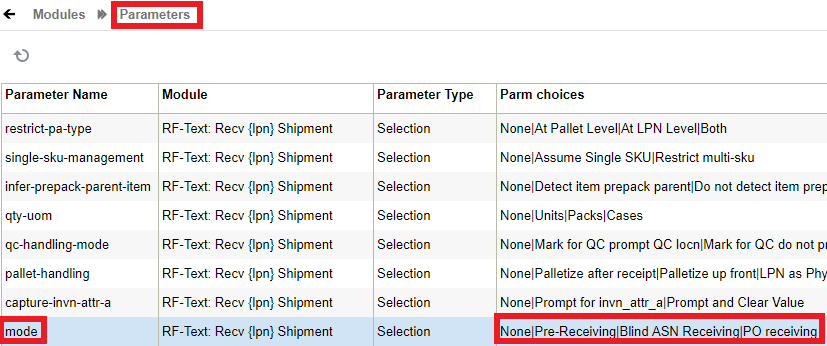

You may want the option to receive inventory against Purchase Orders (POs) without the need of an ASN.
The option ‘PO receiving’ allows you to do this. You can enable PO receiving from the mode parameter in the RF Receive IB Shipment screen.

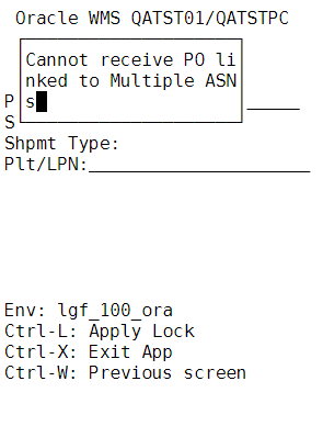

When the prevent-entire-po-to-asn-conversion-flg is set to Blank or No,
- The system converts the entire PO to an ASN during PO based receiving. However, the system converts the entire PO to an ASN only after you scan or skip the trailer scan during PO based receiving.
- In case multiple shipments are created prior to PO based receiving, the system will display the following error message right after the PO scan.
“Cannot receive PO linked to Multiple ASNs”
