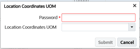

Location Coordinate Base UOM
The Location Coordinates Base UOM field holds the UOM of X,Y,Z coordinates of location such as kms, meters, yard, feet, miles that belong to DIMENSION UOM class.
- Select the facility record from the Facility UI.
- Click Location Coordinates UOM button. This will open the dialog box with
following fields:
- Password: This is a required field and needs admin’s password to proceed.
- Location Coordinates UOM: Select the Location Coordinates UOM from the
drop-down list. This list the UOM descriptions of all UOM Codes where
UOM Class Code is DIMENSION.

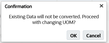

If a value is already selected from the drop-down list and user attempts to save with a different UOM, the system display confirmation message "Existing Data will not be converted. Proceed with changing UOM?
- Click OK to proceed.

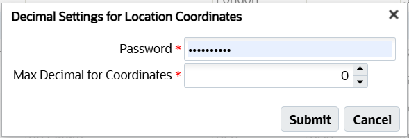

Set Decimal Setting for Location Coordinates
You can set the max decimals allowed for the coordinate values for your facility through the Decimal Setting Location Coordinates action button.
- Click the Decimal Setting for Location Coordinates action button. This will open
the dialog box with following mandatory fields: Note: This button is permission controlled. You need to enable the "Facility/Change Facilities" to access this button.
- Password: Enter user password to proceed.
- Max Decimal for Coordinates: Set the maximum decimal coordinates ranging between 0-25.
- Click Submit. If the new value configured is less than the existing value, then system display confirmation message "The decimal setting will be applicable only to new data. Existing data will not be changed".Note: Whenever you change the decimals coordinates, the system keylogs in the facility UI. For example, if the current value of Max Decimals for Location Coordinates is changed from 2 to 5, the system logs a message "Max Decimals for Location Coordinates changed (2 to 5) by <login_id>".

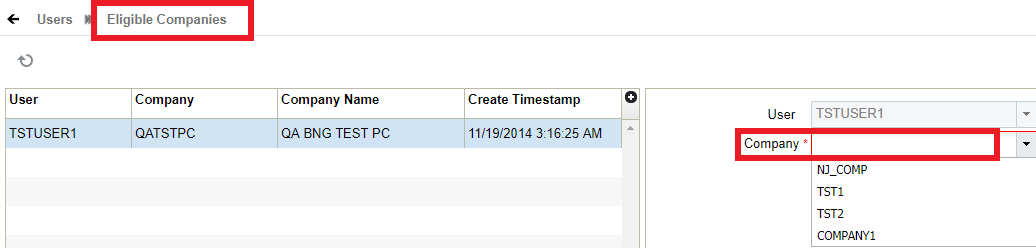

Step 3: Assign Facilities to Users
Once you have created the Companies and Facilities, the next step is to assign them to users. This step defines the list of companies and facilities that you will have access to.
- Go to the “Users” screen.
- Select the user to modify.
- Click on “Eligible Facilities”.
- Using the Create (
) button, add the Facilities that this user will have access to. - Repeat steps three and four for adding Companies (using the “Eligible
Companies” button).

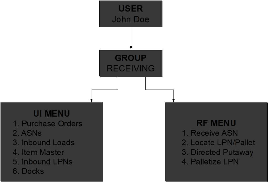

The following is an example of a User/Group set up:

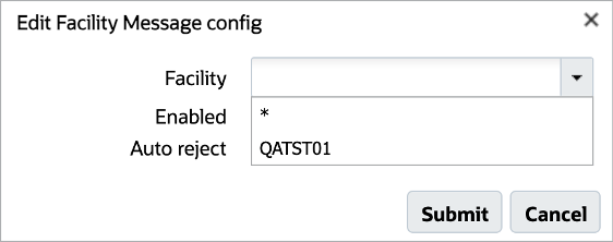

Edit Message Configuration for Facilities
In the Message UI > Edit Message Facility Message Configuration
section, you can select ‘*’, option from the Facility drop-down menu to
update the settings for multiple location in One-Go. This option will automatically
update the change to all eligible facilities you manage, eliminating the need for
repetitive updates.
- Navigate to the Message UI.
- Select Edit Message Facility Message Config option.
- In the Facility Drop-down, select the * to apply changes across all your eligible facilities.
- Click Save.. On success, a confirmation dialog appears for you to confirm the changes applied to all eligible facilities.
- Confirm the action to proceed. Upon saving, the system will automatically update
the message configuration for every eligible facility linked to your
account.
NOTE: Enable and Auto Reject checkboxes are blank by default. You can adjust these settings accordingly to enable or disable messages, and set auto rejection rules.
