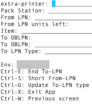

  1. Enter the “Repack” RF module.
  2. Depending on which parameters are activated, the RF displays a different number of fields. The figure below shows all of the possible fields for the RF.
Repack RF Screen
Figure 298: The repack RF screen
  • Extra-printer: Scan the laser printer barcode (this is to print the packing slip)
  • Pack Station: Scan the Packing Station in which the OBLPN will be packed.
  • From LPN: Scan the OBLPN to pack from (this is the OBLPN in “Picked” status).
  • From LPN units left: This field displays the number of units there are left to pack from. As the user scans each unit from the “From LPN”, the quantity will decrease.
  • Item: Scan the item code.
  • To OBLPN: This is the OBLPN that you will pack to (also known as the “final OBLPN”).
    • If the allocation is not cubed, WMS will not prompt an OBLPN number. You will manually choose the LPN to pack to, followed by the OBLPN Type.
    • If the allocation is cubed, WMS will pre-assign an OBLPN with the OBLPN number and LPN Type.
      • When the “From LPN” is emptied, the RF cursor will return to the “From LPN” field and prompt you for another OBLPN to pack from.

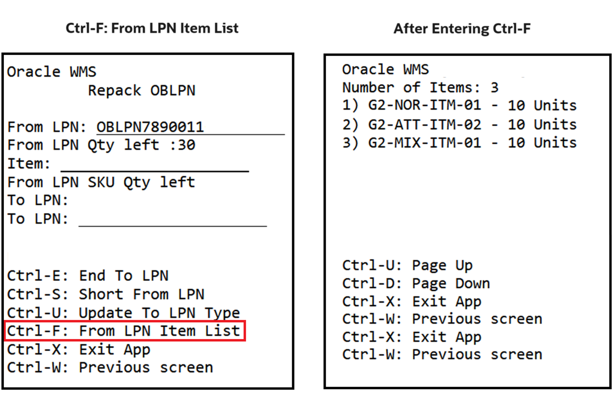

Ctrl-F Hotkey Behavior
The “Ctrl-F (From LPN Item List)” hotkey in the RF Repack OBLPN (rf.outbound.cwrfrepackoblpn) transaction displays all inventories within the source OBLPN. You can preview the unpicked items before initiating the repack, making planning efficient.
During the RF Repack OBLPN transaction, when you enter the “Ctrl-F (From LPN Item List)” hot key, the system displays the list of unpicked items in the source OBLPN with quantity and UOM (“item code” – “quantity” “UOM”).
Ctrl-F Hotkey
Key Notes for Consideration
  • After invoking the hot key, the system displays the list of items (unpicked) present in the OBLPN. If you pick any item during the RF Repack OBLPN transaction, the system doesn’t display the picked item in the item list again.
  • The system doesn’t display the items with zero inventory.
  • If the same SKU has multiple lines of attributes/batch combination, the system displays the total quantity of the SKU.
  • The system displays the UOM based on the item’s Primary UOM.
