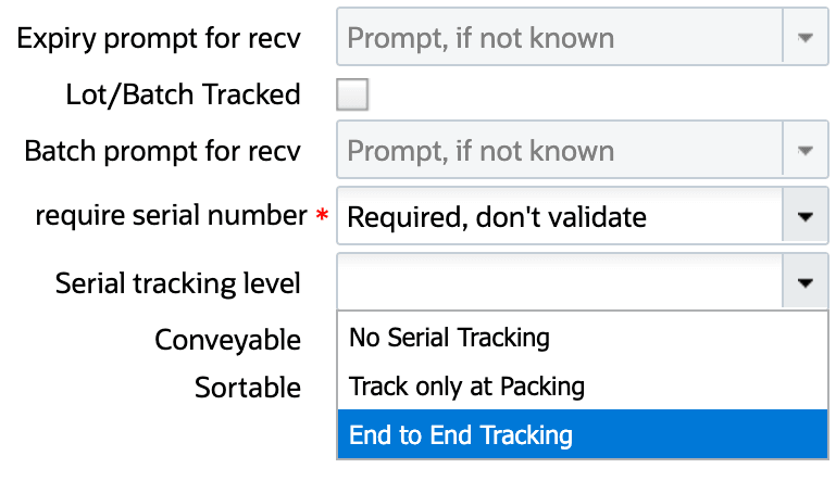

To set the serial-tracking level for a serial-tracking item, do the following:
  1. From theItemsUI, select the desired serial tracking item.
  2. Click the “Item Detail” button.
  3. Click the “Edit” (pencil) action button at the bottom of the screen.
  4. Click the “require serial number” drop-down field.
  5. Select between the drop-down options: “Required, don’t validate” and “Required, validate and allow user override”, as per requirement.
    Note: If you select the “Not required” option, you won’t be able to set the serial-tracking level for that item.
  6. Click the “Serial tracking level” drop-down.
  7. Select the required tracking level for that item between the drop-down options: “No Serial Tracking”, “Track only at Packing” and “End to End Tracking”.
For example, let’s say, we have serial number tracked SKUs A and B with the Company Parameter Value set as 2. Now, SKU A is configured to serial number tracking level 0 and SKU B is configured to serial number tracking level 2. Here, SKU A will not be serial number tracked, whereas, SKU B will be serial number tracked from end-to-end.
