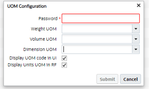

A new action button ‘UOM Configuration’ is available in the Company UI to configure UOM at the Parent Company level.
This action button is only available if the selected company is a Parent Company. Parent companies have the field set up with a *. Once you configure UOM values for Weight/Volume/Dimension, the respective facilities associated with the parent company are pre-populated with same value.
This new action button allows you to configure weight/volume/dimension UOMs.

If this flag is enabled in the Company UI, then you can configure 'Units' to be displayed in the RF screens. The flag will also display quantity fields UOM. You can also disable the flag to exclude UOM information.
- If the UOM class is different for the item that you are scanning, the UOM associated with the item is displayed along with the quantity field.
- If the configuration is at the parent company level, all the child companies within the same parent company will have the same setting.
- If the selected company is a Parent company, the UOM Configuration action button is enabled and you can choose to display the UOM code in the RF screen by enabling the flag.
