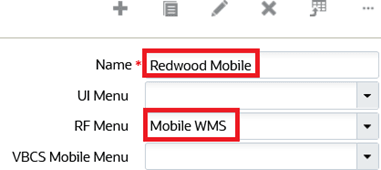

- From the Menu Configuration UI, click the "+" icon button at the top right of the Menu UI screen.
- To assign the Menu to the group, go to the Group Configuration UI > click
                    the RF Menu > add the Menu here, and make sure VBCS Mobile Menu is empty.
                    This can be done to an existing or a new group.
- Create a user with your preferred group name (for example, Mobile App) or you
                    can also update an existing user with the group. Assign the default group to the
                        RF Mobile (here, Mobile App) menu you created.- Click "Add to Current Group Menu" to add the created screen to group menu.
- Click OK to confirm the action.
- After adding the screen successfully, the system displays the following
                            pop-up window. Click OK.
