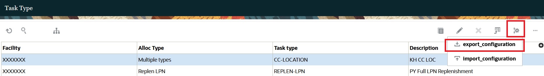

  3. On the right corner of the UI’s table, click “config” action button.
  4. In the drop-down options, click “export_configuration” option.
    Export Configuration
    The system prompts to save the configuration file (.cfg file format) that needs to be downloaded in the local file system.
    Note: You have to enable download permissions on your browser to download and save the export configuration file.
  5. Select the folder location and click Save.
Note: The downloaded configuration file is an encrypted text file. So, any attempt to modify the file corrupts and render it as un-importable.

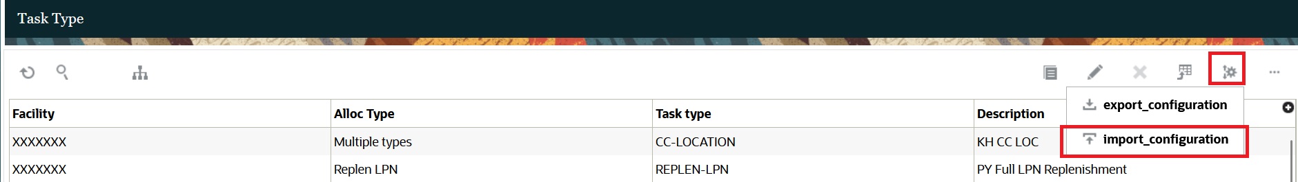

  2. On the right corner of the UI’s table, click “config” action button.
  3. In the drop-down options, click “import_configuration” option.
    Import Configuration
  4. On the dialog box screen, click “Choose Files” button.
  5. Then, select the previously exported configuration file and click Upload.
