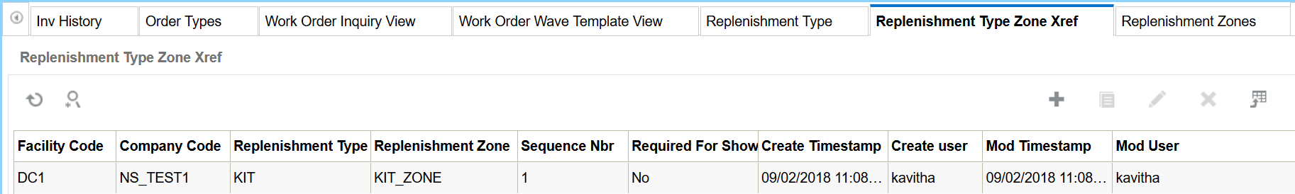

    - From the Replenishment Type UI, create a Replenishment Type for kitting.
 - Create a Replenishment Zone for kitting.
 - Tie the Replenishment Type with the Replenishment Zone.

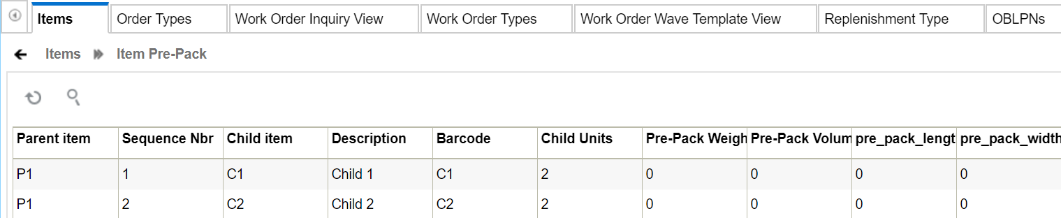

 - Parent and child items need to be pre-defined along with the pre-pack
                            ratio.

                        2.Note: Since this replenishment zone (KIT_ZONE) has been tied to the replenishment type (KIT) and the replenishment type is configured on parent item P1, this would mean that whenever parent item P1 needs to be built, the child items for P1 will always be replenished to assembly location AS111. Similarly, different parent items can be configured to be assembled in different assembly locations.
