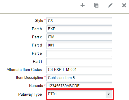

If it is determined that the item level will be used, the following steps explain how to add a putaway type to an item.
- From the “Items” screen, select the item that requires a putaway type defined, and click Edit ().
- Scroll down until the ‘Putaway Type’ drop-down is visible. Click on the drop-down
and select the applicable putaway type.
- Once the putaway type has been selected, click the ‘Save’ button to save the changes
made to this item.Note: If the item master is interfaced into WMS, the putaway type can be defined ahead of time. The field associated with the putaway type on the interface file is ‘putaway_type’.
