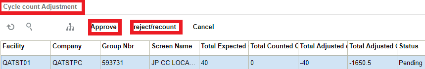

Approving and Rejecting Adjustments in Deferred Mode
The Deferred Mode allows supervisors to approve/reject inventory adjustments made by users who have previously Cycle Counted locations.
To approve/reject records, make sure it is in “Pending” status and click the “Approve” or “Reject/Recount” buttons.
- To use the Approve action button, enable the group permission “location / Approve CC Adjustments”.
- To use the Reject and Cancel action buttons, enable the group permission “location / Reject or Cancel CC Adjustments”.
To control the Reject and Cancel action buttons, you must manually enable the group permission “location / Reject or Cancel CC Adjustments”.
Users with the "Administrator" role can Approve and Reject Cycle Count adjustments by default. To grant the group permission “location / Reject or Cancel CC Adjustments” to users with other roles, such as "Management", it must be added to their respective groups.
Approving a record applies the inventory adjustments by adding/subtracting inventory from the locations as well as posting records in the Inventory History screen (referenced by the Group Number).

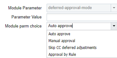

Deferred Approval Mode set up in RF Cycle Count Transactions
Previously, when performing a Cycle Count with RF Cycle Count Location or RF Cycle Count IBLPN, you would use the screen parameter “auto-approve-mode (update 18C).” This screen parameter is now called “deferred-approval-mode.”
The deferred_approval_mode parameter makes it easy for you to distinguish the approval modes available while you are performing cycle counting operations.
From Modules, select Cycle Count Location or Cycle Count IBLPN, then Screens, and Screen Parameters to view and select your module parameter choice.
The available settings for the Deferred-Approval-Mode screen parameter are defined in the following table:
| Mode | Definition |
| Manual Approve | When "deferred-approval-mode" is set with Manual Approve, "RF Cycle Count Locn/IBLPN" writes the count information in the CC Deferred Adjustment UI and will leave the information for the supervisor to approve or cancel the count if supervisor is logged in with company and facility combination and mode is configured with deferred mode. |
| Auto Approve | When "deferred-approval-mode" is set with Auto Approve, RF Cycle Count Locn/IBLPN" writes the count information in the CC Deferred Adjustment UI and will get Auto Approved after passing through all the validations if user is logged in with a company and facility combination and mode is configured with deferred mode. |
| Skip CC Deferred Adjustment |
| Approval by Rule |
