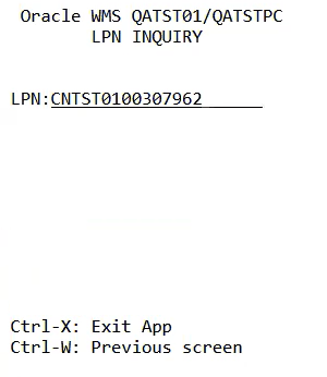

  2. Enter or scan an LPN or Container Number.
    LPN Inquiry LPN Scan

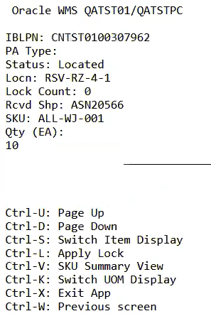

    Based on the screen parameter configuration, the system displays multiple details of LPN. The details vary for IBLPN and OBLPN.
    • If you scan an IBLPN, the system displays the following details.
      • Putaway Type
      • Container Status
      • LPN’s current location
      • Lock code count
      • Received Shipment Number
      • SKUs that are part of LPN
      • SKU’s quantity along with UOM
      • SKU’s inventory attributes, expiry date, or batch number (if SKU is tracking these and RF screen parameters are configured to display these)
      LPN Inquiry IBLPN Scan SKU Details
      Note: If the scanned LPN is a multi-SKU LPN, hit “Ctrl+D” hot key to view the remaining inventory line (SKU) details.

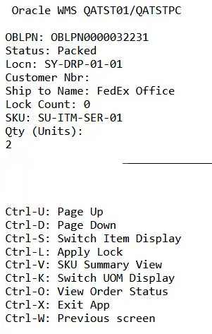

    • If you scan an OBLPN, the system displays the following details.
      • Container Status
      • Ship-To Facility code (for facility order or store order)
      • Customer Number (for customer order)
      • Ship to Name (for customer order)
      • Lock code count
      • Pallet Number
      LPN Inquiry OBLPN Scan SKU Details
    Note: While inquiring an LPN, the system displays inventory lines with Current Quantity = 0 in any Container Status, because of the following reasons:
    • To keep the historical track of LPN inventory lines that are modified to Cancelled/Consumed status with current quantity = 0.
    • OBLPNs in “Outbound Created” status may have in-transit quantities with current quantity = 0.
