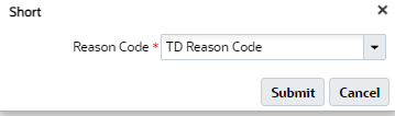

    Once you click Short, the system will prompt you to add a Reason Code:
Reason Code Prompt
After the movement request is shorted, refresh your Movement Request Detail and Movement Request Header screens, and then the status should move to “Cancelled.”
If you click Cancel, a message is displayed with number of movement request details successfully canceled. The message will also display the number of records subjected to cancel. This will include the count of filtered records.

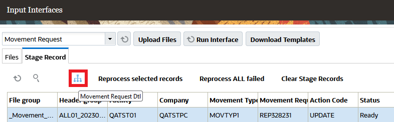

Input Interface
Movement Request is now an option in the Input Interface UI. This will allow external systems to create bulk Movement Requests. The interface will accept XML format.
From the Input Interface, you can access Movement Request from the drop-down. From here, you can access Movement Request Detail and it will show you all the movement requests that have been processed and their correct status. It provides another way for you to manage movement requests. You can view the interfaced movement request records that are in staging, view the status of the interfaced requests and details on errors (if any.)
Input Interfaces - Movement Request Detail
In the Input Interface UI, you also have the option to create or delete a movement request with one or more details by uploading a movement request file (xml and flat files are supported.)
Create/Delete Movement Request Through Init Stage Interface API
You can also create or delete a Movement Request via the Init Stage Interface so that the movement requests created in Oracle Fusion/Manufacturing or any external manufacturing systems can be interfaced with Warehouse Management and the movement requests are created.

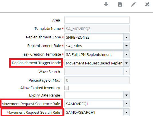

Replenishment Trigger Mode
In the Replenishment Template UI, you can configure a new Replenishment Trigger Mode for movement requests. If Movement Request based replenishment is selected as the Trigger Mode, then the Replenishment logic will only search for eligible movement requests.
Also, when you select Movement Request Based Replenishment as the Replenishment Trigger Mode, the option to select a “Movement Request Search Rule” and “Movement Request Sequence Rule” becomes enabled and allows you to select Movement Request Searches and Movement Request Sequence Rules you have previously created.

If you want to run cancellation waves, you can do this in the Replenishment Template View UI via the following fields:
  • Cancel Partially Allocated – will cancel partially allocated part of movement request line
  • Cancel Fully Allocated – will cancel corresponding unallocated part of movement request line
Movement Request Status Updates
Now, when movement requests are fulfilled through standalone replenishment, in the Movement Request Detail UI, the respective status of movement requests is updated to "Partly allocated" or "allocated", depending on the allocation done. The following table details the status changes that will happen depending on the scenario:
UI Status Changes To
  • "Partly Allocated" - when there is some quantity allocated for the movement request detail but it is less than the movement request detail required quantity
  • "Allocated" - when the quantity allocated is same as the movement request detail required quantity
  • The Allocated quantity in the respective Movement Request Detail will be updated
  • "Partly Allocated" - when any one of the movement request details associated with that movement request header are partly allocated or allocated
  • "Allocated" - when all the movement request details associated with that movement request header have a status of "Allocated"
Update Action Code in Movement Request Interface
If you interface a file with action code UPDATE and there is no existing record found in the application for that Movement Request, the system will create the Movement Request.
Then, if the movement record is already present in WMS, the system will update the existing record.
