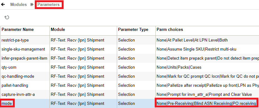

You may want the option to receive inventory against Purchase Orders (POs) without the need of an ASN.

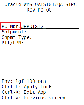

The option ‘PO receiving’ allows you to do this. You can enable PO receiving from the mode parameter in the RF Receive IB Shipment screen.

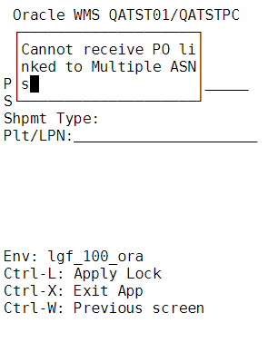

When the ‘PO receiving’ option is enabled, the transaction prompts you to scan a PO Number to initiate receiving.
- If the PO is linked to multiple Inbound Shipments, the screen will provide an
error message and will not allow you to proceed with receiving.
- If the PO is linked to an unverified Inbound Shipment, you can receive against the inventory in that Inbound Shipment, which is equal to the PO’s inventory.
- If the PO is not linked to an Inbound Shipment, the system auto-generates an
Inbound Shipment in the background for the whole PO and allows you to receive.

When the prevent-entire-po-to-asn-conversion-flg is set to Blank or No,
- The system converts the entire PO to an ASN during PO based receiving. However, the system converts the entire PO to an ASN only after you scan or skip the trailer scan during PO based receiving.
- In case multiple shipments are created prior to PO based receiving, the system will display the following error message right after the PO scan.
“Cannot receive PO linked to Multiple ASNs”
