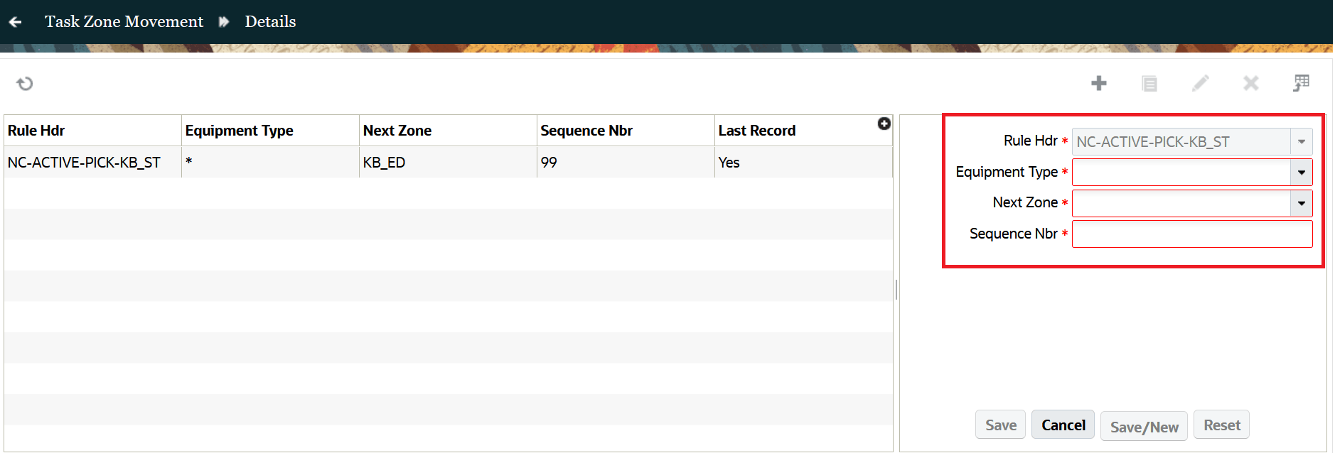

Task Zone Movement Rule
Define the task zone rule for every task zone movement by entering the mandatory information in the field as shown in the screen below:
