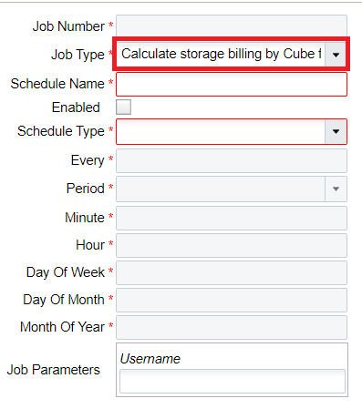

To set up the schedule job type, do the following:
- From the Scheduled Jobs screen, click Create (+).
- Select Calculate storage billing by Cube for location from the Job Type
drop-down.
- Populate the required fields and Click Save.
