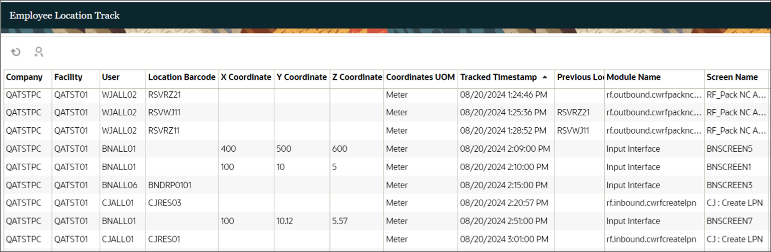

Employee Location Track
Some of the key fields that are captured during location scan using WMS handheld is listed below:
  • User: Employee that scanned the location
  • Location Barcode: Barcode of the location scanned by the employee
  • Tracked Timestamp: Date and time at which the location was scanned
  • Previous Location Barcode: Barcode of the previous location that was scanned by the user (if any)
  • Module Name: Module Name of the WMS handheld screen
  • Screen Name: Name of the WMS Screen that the employee was using when location was tracked
  • Equipment Type:An identifier representing the equipment (if any), that the employee was operatingwhen the location was scanned
  • Task Nbr: Task, if the activity was being performed in tasking mode
  • Task Type Exec Seq Nbr: Execution seq nbr of the task, if the activity was being performed in tasking mode
  • IHT Group Nbr: Group Nbr of the Inventory History transaction if WMS has this information at the time the record is written
  • IHT Sequence Nbr: Sequence Nbr of IHT Group, if WMS has this information at the time the record is written
