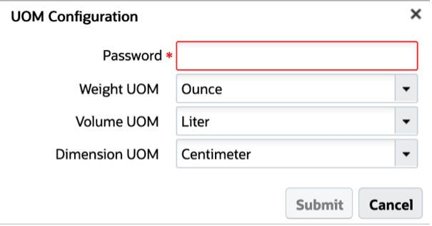

Configure UOM at the Facility Level
When you are a company with multiple facilities in different geographical locations, each facility may want to define different UOM for Weight/Volume/Dimension class. By allowing you to define UOM at the facility level, you have the flexibility to make transactions easily within your facility. A new action button in the Facility UI (UOM Configuration) allows you to configure UOM at the facility level.
The default for the UOM Configuration action button is enabled when the selected facility is associated with the company. You can select multiple facilities and define UOM across facilities in a single instance.
To enable the UOM Configuration button, assign the Facility/UOM/ Configure UOM permission.
To configure values in the UOM Configuration for Weight/Volume/Dimension class:
- Click UOM Configuration.
- A pop-up window appears where you can define the Weight, Volume, and Dimension
class based on the UOM configured in the new UOM UI screen:
- The weight UOM drop-down should display the UOM's Code configured for Weight class.
- The volume UOM drop-down should display the UOM's Code configured for Volume class.
- The dimension UOM drop-down should display the UOM's Code configured for Dimension class.
- Click Save to save the changes.
- If the respective UOM class is defined with value at company level, you cannot save blank value against any of the UOM class.
- When you save UOM class for the facility and the associated company is not configured for the respective UOM class, the system displays an error message ‘Cannot save value for %UOM class% as respective UOM is not defined at company level’.
- Default value for Weight/Volume/ Dimension UOM fields are pre-populated from respective company setting and you can select value against each UOM class and save the value.

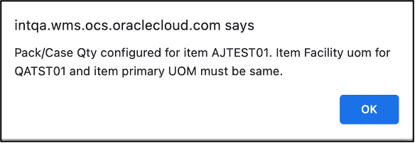

Maximum for Primary UOM in the Item Interface
The system will allow a maximum of one configuration of Primary UOM, if both Primary UOM and Item Facility Primary UOM are the same.
When the Facility UOM is different from the Primary UOM and you try to update the Case or Pack quantity, the system will display an error in the item interface “Pack/Case Qty configured for item XYZ. Item Facility UOM for QAEST01 and item primary UOM must be same”.
When the Facility UOM is different from the Primary UOM and you delete or make the Facility UOM the same as the Primary UOM, the system allows you to update the Case/Pack quantity greater than zero.

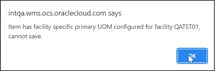

Maximum for Item Facility Primary UOM in the Item UI
In the Item UI, the system will restrict configuration of standard pack or standard case quantity with value greater than zero is the item Primary UOM is different than item Facility UOM. The system displays an error ‘Item has facility specific primary UOM configured for facility , cannot save’ upon saving the item.
