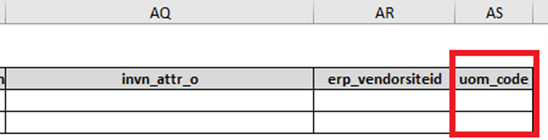

Now with UOM support in Input Interfaces. Vendors will have the ability to send different entities with different UOM’s to the Warehouse Management. WMS converts the UOM sent by the vendor to the respective UOM tracked in the WMS. This change helps the floor users to track the WMS entities in their respective UOM.
New fields have been introduced for different entities to track the quantity/weight/volume/dimension
- uom_code ( This field will be used to specify the UOM sent for quantity)
- weight_uom_code
- volume_uom_code
- dimension_uom_code
- The uom sent in the quantity fields should be within the same uom class as the item’s primary uom. In case of multiple details, then you can send different UOMs provided it matches with primary UOM class of respective items.

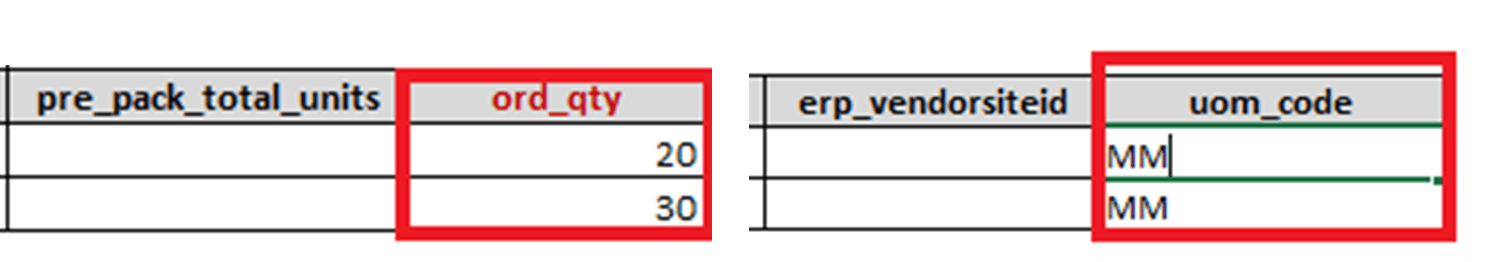

Defining UOM in the Interface File
- For example, in the Purchase Order Detail interface file, enter the ord_qty
value and define the uom_code in the respective columns.

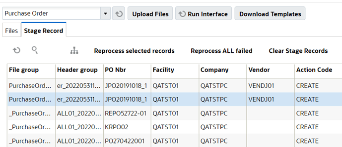

- Upload the interface file and Run Interface.Note: You can download the latest templates of the interface files from the Download Template folder.
