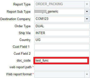

Company Report Type can summon any Label Designer template that was created from scratch using that tool. Additional configuration is also available if your current operational flow requires it. Follow the above steps if you need to create or modify a current report.
Complete the following steps for additional configuration:
- In this example, once the doc_code field has a value that matches an actual Label Template Code, then the system will not take into account the Report Sub Type value.
