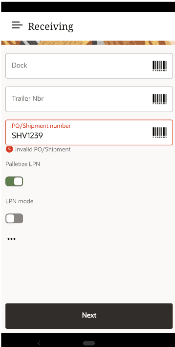

    In order to find if the number entered is a PO or Shipment Number, the system will first look at the PO table and search for a matching number whose status is < than Received. Otherwise, it will look into the Shipment table and search for a matching number where the status is < than Receiving Complete.
    1. If an invalid PO or Shipment number is entered, the system displays an Invalid PO/Shipment error message. For example,

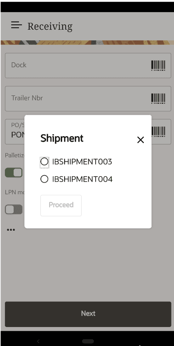

      Invalid PO Number
    2. If a value is available in the PO table, and the PO is related to multiple shipments, then a pop-up is displayed for you to provide with the Shipments linked to the PO. It will only show Shipments that are in a status less than receiving completed. On selecting the shipment value, the system will start the receiving process for the IB Shipment.
      Inbound Shipment

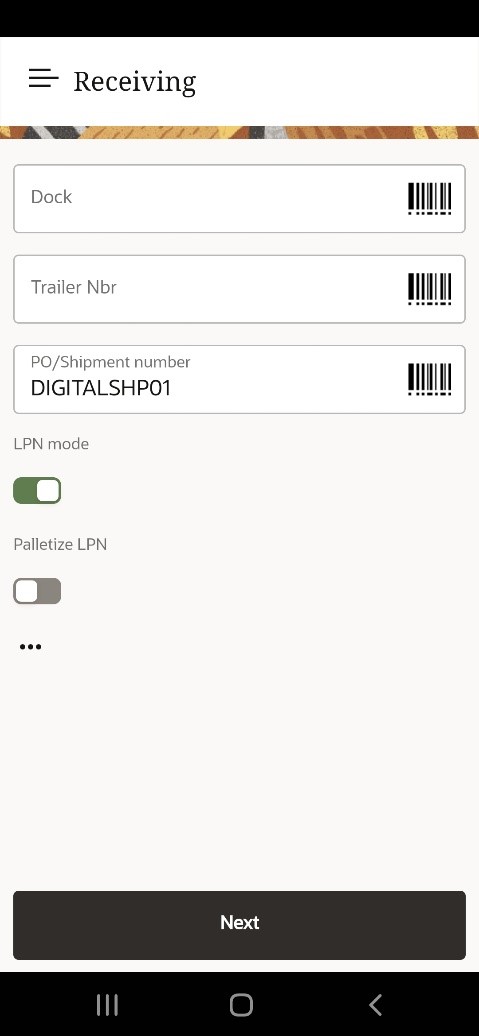

LPN Mode Receiving
  1. If Palletize LPN toggle and LPN Mode toggle is enabled. The system prompts for the pallet number in the next screen.
  2. Click Next.
  3. Enter the Pallet number in the Pallet Nbr field.
  4. Select the type from the list of values in the LPN type drop-down field.
  5. Choose the Pallet contains type:

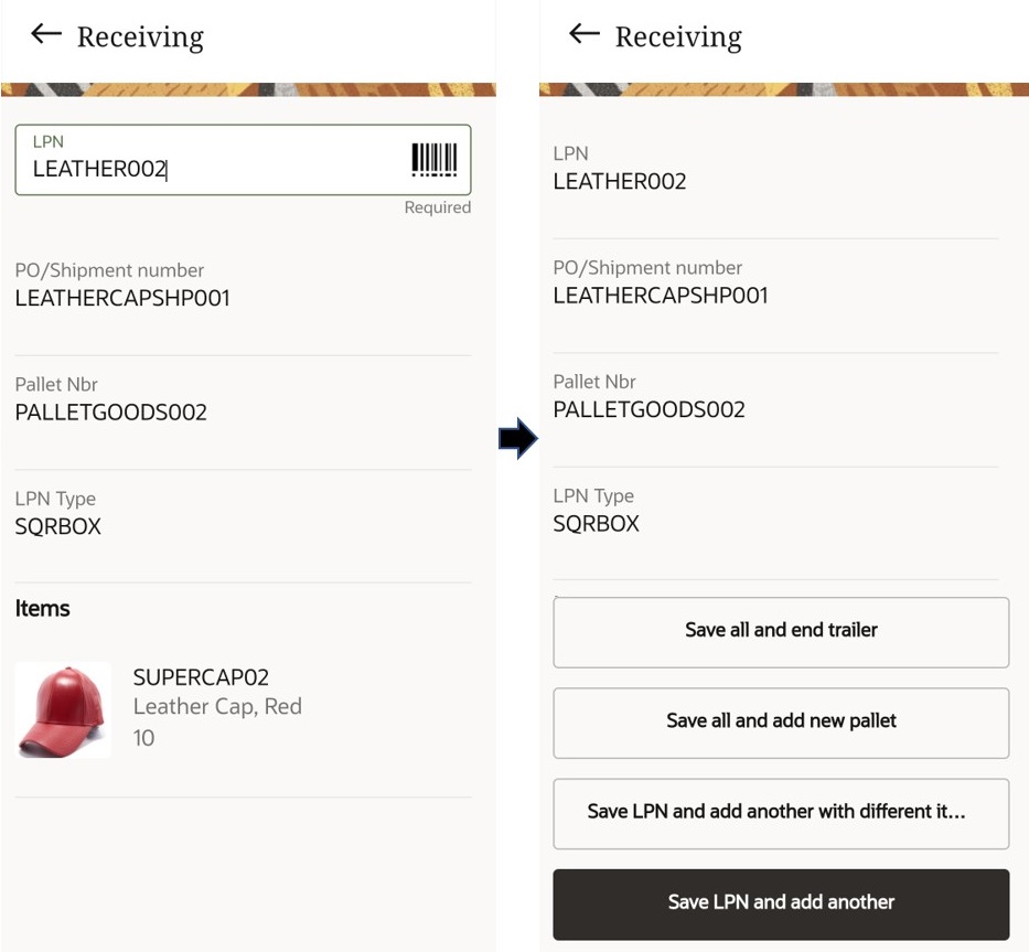

    1. Click Single item LPNradio button to receive single item LPNs and click Next.
    2. Enter the LPN number in the LPN field > Enter the item Barcode in the Item Barcode field.
    3. Enter the quantity in the Units to receive > Quantity field.

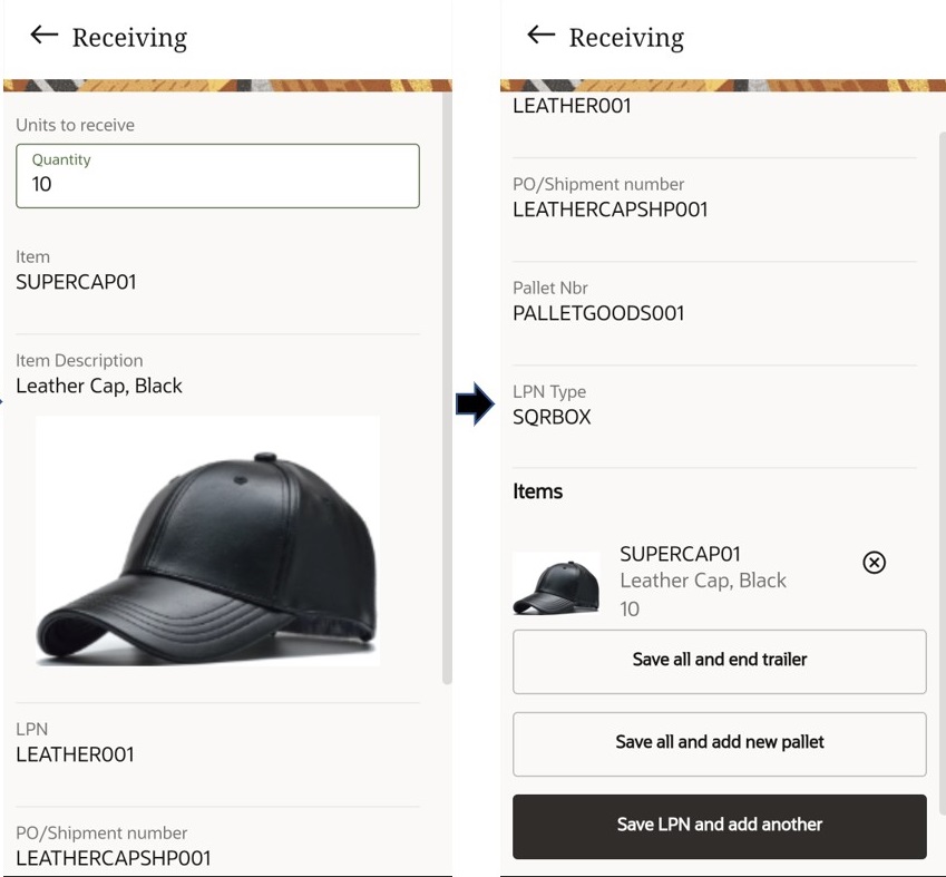

      Single Item LPN Mode Receiving
      After successful receiving, the summary screen is displayed with the following options:
      Summary Screen
      Options Description
      Save all and end trailer Saves all the records, ends the trailer, and the app routes you back to the main Receiving screen to scan a new shipment.
      Save all and add new pallet
      Saves all the LPN records and ends the current pallet. You can use this option to add the remaining SKU from the same shipment but on a new Pallet. The screen flow returns back to the Pallet screen where you scan a new pallet number.
      Note: Enter a different LPN number for the new pallet.
      Save LPN and add another Save the current LPN and add the same or different SKU from the same pallet but on a different LPN. The screen flow returns back to the LPN screen where you can scan a new LPN for the same pallet.

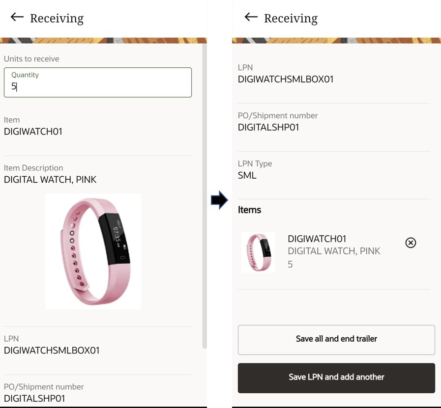

      1. Multi-item LPN: Supports receiving of multi- item LPNs.
        1. Select the Multi-item LPN button and click Next.

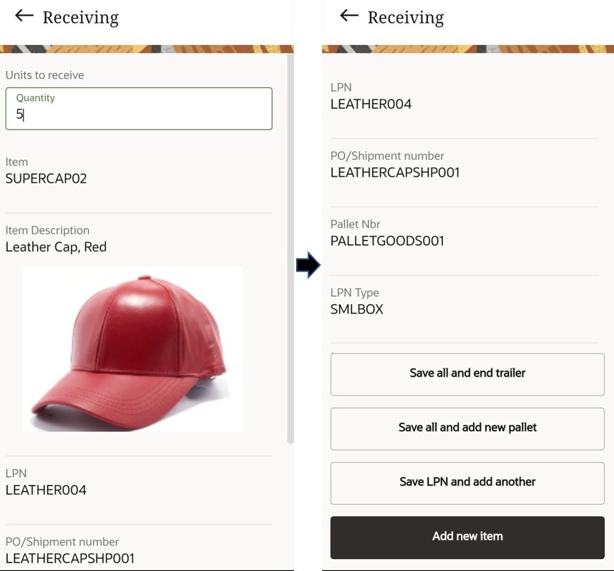

          Multi-Sku LPN Mode Receiving
        Summary Screen
        Options Description
        Saves all the LPN records and ends the current pallet. You can use this option to add the remaining SKUs from the same shipment but on a new Pallet. The screen flow returns back to Pallet screen where you scan a new pallet number.
        Add new item This option is visible only if you receive multiple items by selecting Multi-item LPNs radio button Pallet screen. On tapping this option, the application takes you back to scanning the item barcode screen.

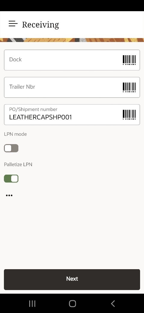

Receiving LPN or SKU without Palletize mode
The following depicts the flow of receiving for a non-palletized shipment:
  1. From the Receiving screen, enter the PO/Shipment number. If Palletize LPN = disabled and LPN Mode = disabled/enabled, the application prompts you to the LPN type screen.
    Non-Palletize mode
  2. Click Next.
  3. Choose the LPN type from the list of available LPN type descriptions > Click Save.
  4. Enter the LPN number in the LPN field > Enter the item barcode from the Item Barcode field.
  5. Enter the quantity in the Units to receive > Quantity field.
    Receiving LPN without Palletize mode

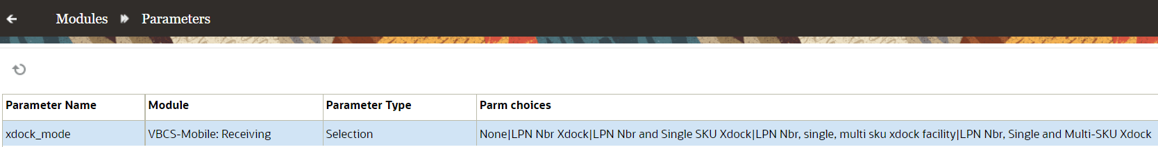

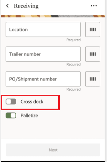

Cross Dock LPNs during Receiving
In your Receive module, enable the “Cross dock” toggle. On launching the receiving module, the Cross-dock toggle will be disabled, by default.
Cross Dock
To help reduce the time needed for order fulfilment during receiving, configure the xdock-mode in the receiving module with the following parameter values:
Xdock Mode
XDock Mode Parameter
Parameter Values Description
None Do not cross dock
LPN Nbr and Single SKU Xdock The system first checks the receiving LPN with the orders and their required LPN number. If the LPN number does not match, then the system will perform single SKU Xdock until the single SKU LPN.
LPN Nbr Xdock Checks the receiving LPN with orders that required LPN number.
LPN Nbr , single, multi sku xdock facility The system first matches the LPN with an order. If the LPN number does not match, then the system will Xdock single sku. If the LPN is multi sku, the system will Xdock facility, only if it is a facility order.
LPN Nbr Single and Multi-SKU Xdock The system first matches the LPN with an order. If the LPN number does not match, then the system Xdock single sku but if the LPN is a multi sku, then the system will Xdock.
