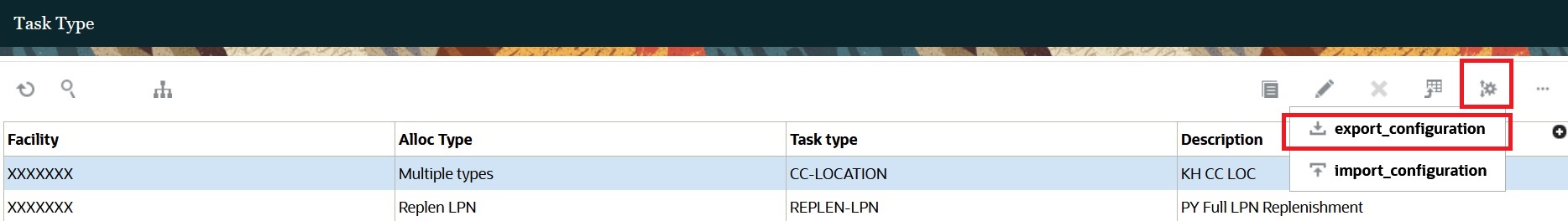

Export Configuration
You can export configurations for either selected rows or for entire screen. If the screen supports the “config” action button, then you can export the screen configuration.
To export the configuration, do the following:
- Go to your preferred UI or screen that supports config action button (applicable UIs or screens mentioned in the above list).
- Select the records to export.Note:
- If you are not selecting any records, the system exports all data available on the screen.
- Searching for a few rows and then exporting without selecting any record will still export all data (regardless of what was searched).

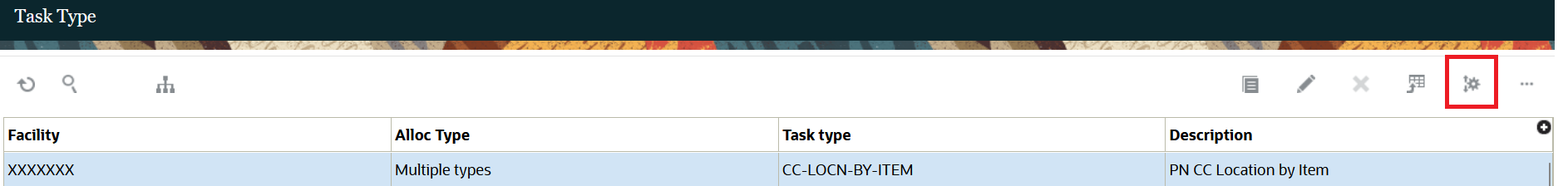

- On the right corner of the UI’s table, click “config” action button.
- In the drop-down options, click “export_configuration” option.
The system prompts to save the configuration file (.cfg file format) that needs to be downloaded in the local file system.
Note: You have to enable download permissions on your browser to download and save the export configuration file. - Select the folder location and click Save.

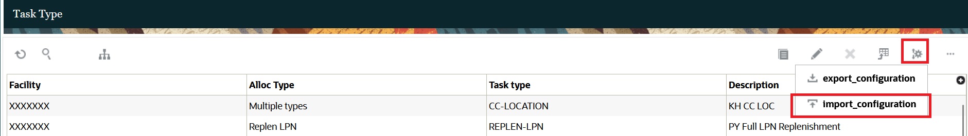

Import Configuration
You can import configurations to create new records or update existing records, but it does not delete existing records on the supported screen. If the screen supports the “config” action button, then you can export the screen configuration.
Importing configurations depends on the unique field names of the screens.
For example, assume that you have a task type description record “Internal Pick” on the source environment and on the target environment for Task Type UI.
If editing your source screen’s (Task Type) task type description to “Internal LPN Pick” and importing this configuration, the system will no longer find the “Internal Pick” task type description but creates a new “Internal LPN Pick” task type description record for the screen in the target environment.
The target environment for importing configurations can be:
- The same Facility/Company in the same environment. This is useful for restoring from a backup.
- A different Facility/Company but in the same environment. This is useful for replicating configurations done for one Facility in another Facility.
- The same Facility/Company in a different environment.
- A different Facility/Company in a different environment.
- The exported configuration file must be from an environment with a matching major release number (such as 23B or 23C).
- Currently, there is no support for automatic backup of the current configuration when an import is done. So, while importing configurations, it is always recommended to export configurations first for backup.
- The exported configuration file (.cfg file format) must be unedited manually.
To import the configuration, do the following:
- Go to the UI or screen that supports config action button (applicable UIs or screens mentioned in the above list).
- In the drop-down options, click “import_configuration” option.
- On the dialog box screen, click “Choose Files” button.
- Then, select the previously exported configuration file and click Upload.
