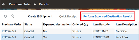

Perform Expensed Destination Receipt Action Button
You can receive expensed destination receipt through the action button “Perform Expensed Destination Receipt”. This helps you to receive PO details record from the PO Detail screen and is disabled, by default. On selecting one or multiple PO details with the Expensed Destination flag set to Yes, the system enables the “Perform Expensed Destination receipt” action button.
To perform expensed destination receipt, do the following steps:
  1. Navigate to Purchase Order > Purchase Order Details UI.
    Note: The Perform Expensed Destination Receipt action button is access controlled and requires enabling the permission “permission “purchase order hdr/Allow Expensed Destination Receipt” to perform the transaction”.
  2. Select the PO details with expensed destination flag = Yes, to perform Expense Destination receipt.
    Expense Destination Receipt
    You can now multi-select PO details that are enabled with the Expensed destination flag and can perform the Expensed destination receipt from the PO detail UI screen. This action is enabled only for receiving expensed destination PO details.
    Note: The Perform Expensed Destination Receipt action button is access controlled and requires enabling the permission “purchase order hdr/Allow Expensed Destination Receipt” to perform the transaction.

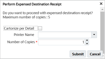

  3. A Perform Expensed destination receipt window pops-up, enter information for the following fields:
    Perform Expensed Desination Receipt
    • Cartonize per Dtl: Enabling this checkbox allows you to create one LPN per PO detail.
      Disable/uncheck will create a single LPN per receipt (all selected PO details go into single LPN). However, the auto-generated LPN are auto consumed.
    • Printer Name: Select the printer’s name to print the LPN labels after receipt.
      Here, the LPN will be received first, followed by LPN label generation, and then auto consumption.
    • Number of Copies: Enter the number of copies.
      These fields are non-mandatory. You can proceed with receiving without providing the values in the above fields.
  4. Click Submit.
All the inventories of the expensed PO details received via this action button are auto consumed. On proceeding, the system auto generates an ASN and an LPN number per receipt based on the Sequence counter configurations of Blind LPNs and Blind Receiving Inbound Shipment respectively. On successful receipt, the IHT-1-LPN Received and IHT-2-Container Consumed are captured.
