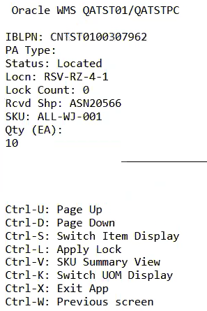

- If you scan an IBLPN, the system displays the following details.
- Putaway Type
- Container Status
- LPN’s current location
- Lock code count
- Received Shipment Number
- SKUs that are part of LPN
- SKU’s quantity along with UOM
- SKU’s inventory attributes, expiry date, or batch number (if SKU is tracking these and RF screen parameters are configured to display these)

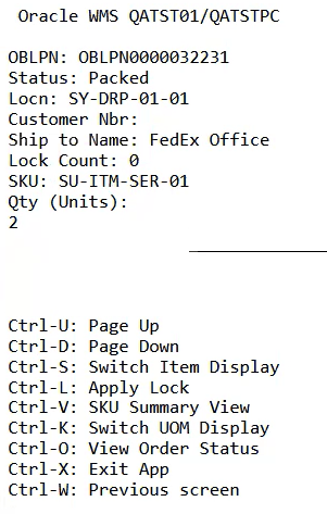

Note: If the scanned LPN is a multi-SKU LPN, hit “Ctrl+D” hot key to view the remaining inventory line (SKU) details. - If you scan an OBLPN, the system displays the following details.
- Container Status
- Ship-To Facility code (for facility order or store order)
- Customer Number (for customer order)
- Ship to Name (for customer order)
- Lock code count
- Pallet Number
Note: While inquiring an LPN, the system displays inventory lines with Current Quantity = 0 in any Container Status, because of the following reasons:- To keep the historical track of LPN inventory lines that are modified to Cancelled/Consumed status with current quantity = 0.
- OBLPNs in “Outbound Created” status may have in-transit quantities with current quantity = 0.
The following table describes the behavior of hot keys on the RF LPN Inquiry screen.
| Hot key | Behavior |
| Ctrl – U: Page UP | Navigates you to previous page of LPN details. |
| Ctrl – D: Page Down | Navigates you to next page of LPN details. |
| Ctrl – S: Switch Item Display | Switches the item field display as per screen parameter “item-field-display” configuration. |
| Ctrl – L: Apply Lock | Navigates you to Lock/Unlock screen for the inquired LPN. (if a valid Lock/Unlock LPN screen is configured in screen parameter “lock-unlock-lpn-screen”) |
| Ctrl – V: SKU Summary View | Displays SKU details. |
| Ctrl – K: Switch UOM Display | Navigates you to change UOM. |
| Ctrl – O: View Order Status | Displays the LPN’s order and order status. (only for OBLPN Inquiry) |
| Ctrl – X: Exit App | Navigates you to the RF main menu. |
| Ctrl – W: Previous Screen | Navigates you to previous screen. |
