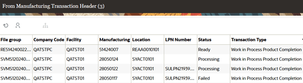

Manufacturing Transaction
You can view manufacturing transaction details including transaction type and status in the From Manufacturing Transaction Header UI. If the item is serial tracked, the UI displays underlying serial number recorded as well.

PROCESS MANUFACTURING TRANSACTIONS AND UPDATES
Once the records are added into the From Manufacturing Transaction Header UI, the corresponding inventory history will be updated once the validations for the records are successful.
For manufacturing transaction records, the location can be drop/reserve/active and for a drop/reserve location, the LPN is mandatory.
- Once the records are picked up for processing, the system will update the status of the transaction to "IN-PROCESSING". Once the updates are successful, the system will update the status to "Completed/Success".
- Depending upon the quantity passed updates could differ for the inventory and corresponding serial numbers.

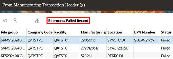

REPROCESS FAILED RECORDS
In certain situations, records sent by manufacturing systems via Inventory Management can fail due to missing items, unnecessary quantities that are present in the application, or corresponding locations that are not configured.
To avoid having to resend failed manufacturing transactions:
- Select the record from the Manufacturing Transaction header UI.
- Click Reprocess Failed Record action button.
- The system displays the Records submitted for processing message and updates the transaction records accordingly.
