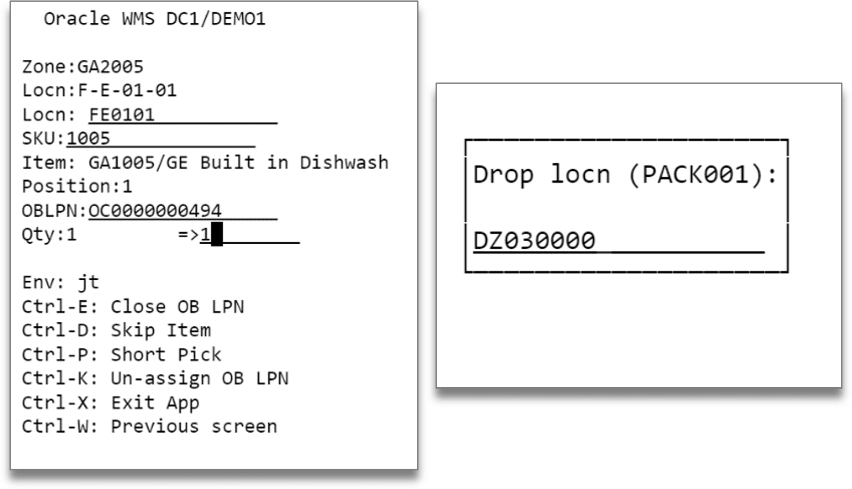

Creating Pick Cart Tasks
You can create pick cart tasks using the following steps:
  1. Prior to picking process, scan a pick cart to begin assigning OBLPNs to a Pick Cart task.
  2. Upon scanning each OBLPN during picking, the system will assign a Position Number to the cart that helps you in directing a product to the correct OBLPN.
  3. Press CTRL+E to close the Pick Cart (or you can scan until you reach the maximum allowed OBLPNs). This will create a Pick Cart task.
    Note: The Task Details will be sequenced by Location Pick Sequence.
    Pick Cart Task
Executing Pick Cart Tasks
  1. Picks are executed on the task based on Location Pick Sequence.
  2. You will be prompted for Location, Item, and Quantity based on screen parameters you configure.
  3. You can confirm picks by scanning the OBLPN barcode or the Position Number based on screen parameters.
  4. After all picks are complete, you can locate the Pick Cart and all OBLPNs to a drop zone location, if necessary.
    Execute Pick Cart
  5. Upon completion, the task Status is updated to Completed.

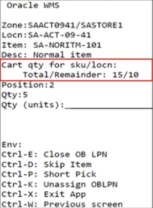

Displaying Total Quantity in RF Pick Cart
The “Show-total-qty-info-for-location-SKU” parameter displays the total units that are picked from a location for your whole cart.
After configuring this parameter, you can save time especially in scenarios where you can pick multiple quantities at a time and distribute them across all the bins in your cart. Knowing the total quantity of items to be picked from a location reduces your movements during picking and this improves your productivity.
Also, knowing the total number of units needed to be placed in the cart improves productivity and speed because the system displays the total units picked and the number of units expected to be placed in each bin.
For example:
Let’s say, you built a pick cart with multiple containers on your pick cart, and the total to be picked from the location/SKU is 15 units. All 3 orders require 5 units of USB cables.
To enable the show-total-qty-info-for-location-sku parameter:
  1. Navigate to the RF Pick Cart Module > Screen Parameter.
  2. Select show-total-qty-info-for-location-sku > set the parameter choice to Yes.
  3. Click Save.
  4. After configuring the parameter, run the RF Pick Cart transaction. The RF Pick Cart screen displays the total quantity to be picked from the location all at once.
    “Total” indicates the total number of units to be picked from a location and “Remainder” indicates how many units are pending to be placed in the bins on the pick cart. To begin with, both these numbers are the same and you are prompted to place 5 units in Position 1. After you place 5 units in position 1 and confirm, “Remainder” is reduced by 5 units, and you are prompted to place 5 units in Position 2.
    Display Total Quantity
  5. The transaction continues until you place all of the units in different positions of the cart as directed by the RF screen. That is, you can walk to the location only once to pick the total units and you place the units in different positions as directed by RF Pick Cart.
