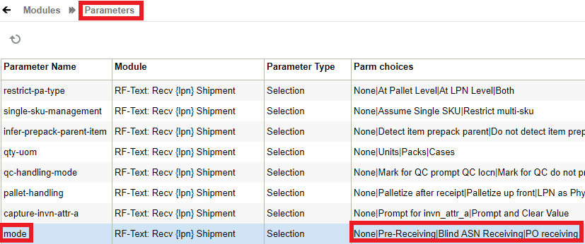

You may want the option to receive inventory against Purchase Orders (POs) without the need of an ASN.
The option ‘PO receiving’ allows you to do this. You can enable PO receiving from the mode parameter in the RF Receive IB Shipment screen.
PO Receiving Parameter Choice

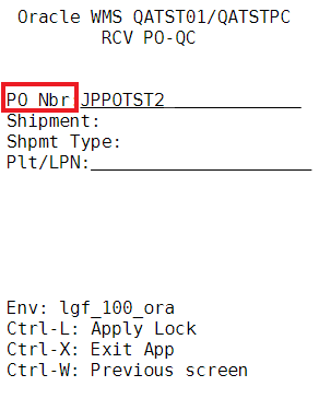

When the ‘PO receiving’ option is enabled, the transaction prompts you to scan a PO Number to initiate receiving.
PO Number Prompt
Once you scan the PO Number:

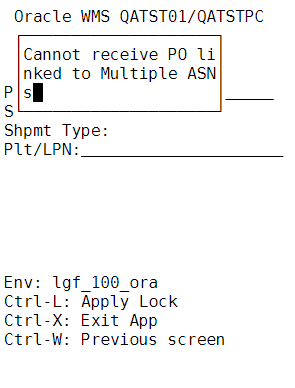

  • If the PO is linked to multiple Inbound Shipments, the screen will provide an error message and will not allow you to proceed with receiving.
    PO Error Message

  • In case multiple shipments are created prior to PO based receiving, the system will display the following error message right after the PO scan.
“Cannot receive PO linked to Multiple ASNs”
