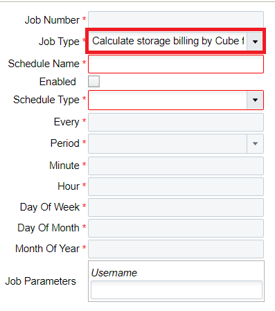

To set up the schedule job type, do the following:
  1. From the Scheduled Jobs screen, click Create (+).
  2. Select Calculate storage billing by Cube for location from the Job Type drop-down.
    Calculate Storage Billing by Cube
  3. Populate the required fields and Click Save.
