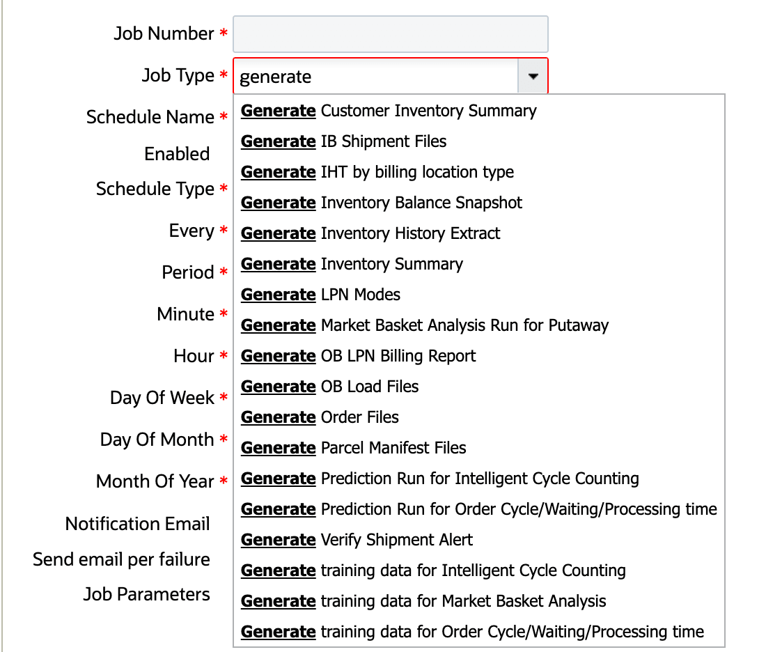

To set up the Generate job type, do the following:
  1. From the Scheduled Jobs screen, click Create (+).
  2. Select the specific Generate Job Type from the Job Type drop-down.
    Generate Schedule Job Types
  3. Enter the mandatory fields for the selected job type. Refer to the How to Set-up Scheduled Jobs with Job Types section for field descriptions.
  4. Configure the respective parameters for the selected Job Parameter – Refer to OWM-ScheduleJob-v1-R21C.xlsx file
