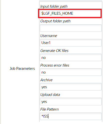

Process Input File - Job Parameter
After you complete all of the required Scheduled Job fields, you need to complete the Job Parameters fields.
The following are the job parameters for the Process Input Files Job Type:
| Job Parameter | Required Action from Users |
| Input Folder path | $LGF_FILES_HOME/interfaces/<company_code>/<fac_code>/input/ Replacing <company_code> with the actual company code and the <fac_code> with the actual facility code. |
| Output Folder path | Not required |
| Username | Enter the username that has access to this facility / company |
| Generate .ok files | No |
| Process .error files | No |
| Archive files | Yes |
| Upload data | Yes |
| File Pattern | ISS*,ITM*,IPP*,IST*,IXR*,IBR*,VEN*,STR*,POS*,ORR*,PLI*,ISH*
(these are prefixes for the different interfaces types such as POS =
Purchase Orders). Note: Only files with the .psv (pipe-separated values) extension
are supported for processing by this schedule job.
Note: Please note that we only support the interface format in the Interface Specs document
Interface Specification 21B.
