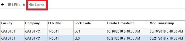

You can add specific Lock Codes to an IBLPN by clicking the blue number value in the “Nbr Locks” column:
This will prompt a new window, where you can add multiple lock codes to the container:
Display of the Lock Codes for a Sample Container

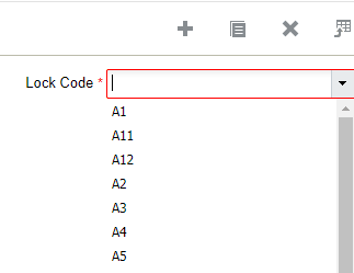

The above figure shows all the Lock Codes currently added to the container. Click Create, and select one of the configured Lock Codes from the drop-down to add lock codes.
select lock codes from drop-down menu
