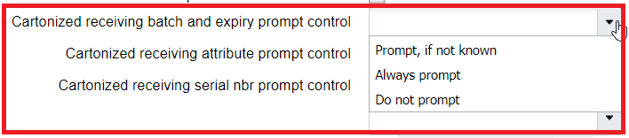

    Three drop-down fields are available on the create shipment type UI along with their values: Configuration Fields for Cartonized ASN
    • Cartonized receiving batch and expiry prompt control: Blank/ Prompt, if not known/Always prompt/ Do not prompt.
    • Cartonized receiving Attribute prompt control: Blank/Prompt, if not known/Always prompt/ Do not prompt.
    • Cartonized receiving Serial prompt control: Blank (Default behavior)/ Prompt, if not known/Always prompt/ Do not prompt.
    If the field is blank, the system honors item level configuration. i.e., Prompt, if not know. However, when Cartonized Receiving for Batch number & Expiry Number /Attribute /Serial prompt control is set to Prompt, if not known or Always prompt or Do not prompt, the system does not honor any of the item property configurations for batch/expiry dates/ inventory attribute/ serial number.

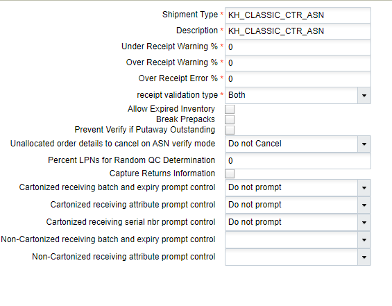

Example: Cartonized ASN - Screen flow for batch/expiry/inventory attribute/serial tracked SKU = Do Not Prompt (Classical Cartonized)
This is a classical receiving behavior and the flag is available on the Shipment type UI to restrict prompting of batch/expiry/inventory attribute/Serial for a single SKU within an LPN, but the system fetches the batch/expiry/attributes from the ASN detail, and the serial numbers are fetched from the IB shipment serial number table.
Note: When configuring the shipment type to Do Not Prompt, you need to populate the batch, expiry date, inventory attribute, and serial numbers on the respective details. Otherwise, the system will not be able to perform Receiving and will prompt you to perform detailed receiving.
Let’s say, you have the following prompt control configured:

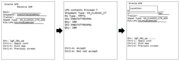

When Cartonized ASN - Screen flow for serial tracked SKU = Do Not Prompt:
After scanning the SKU, the system doesn’t prompt for serial number:

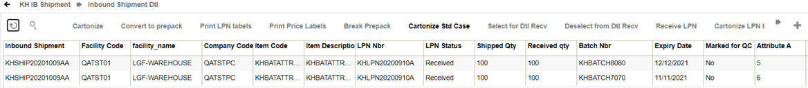

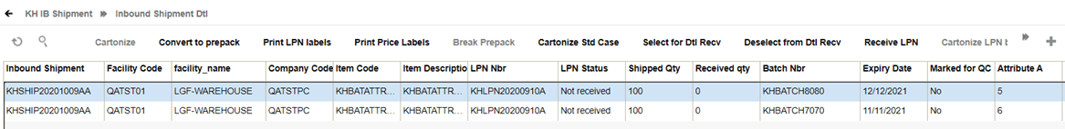

When Cartonized ASN - Screen flow for batch/expiry and inventory attribute = Do Not Prompt
After receiving, the system updates in the following manner:
