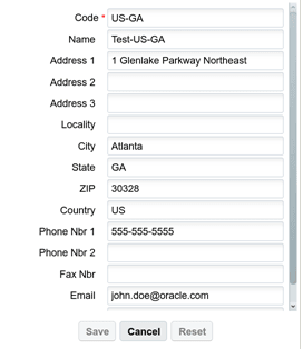

    Step 4: Configuring Contact (Optional)
    Configuring Contact
Description of Fields
  • Code: the reference code value that is used to lookup and identify a particular contact.
  • Name: the name of the contact.
  • Address 1: first line of the address.
  • Address 2: second line of the address.
  • Address 3: third line of the address.
  • Locality: if the address has a locality needed in certain countries etc.
  • City: if the address has a city.
  • State: if the address has a state.
  • Zip: the zip portion of the address.
  • Country: portion of the address.
  • Phone Nbr 1: first / main phone number of the contact.
  • Phone Nbr 2: secondary phone number of the contact.
  • Fax Nbr: fax number of the contact.
  • Email: the email address of the contact.
  • Contact: the contact person you would want to get a hold of at the address / phone number / email.
