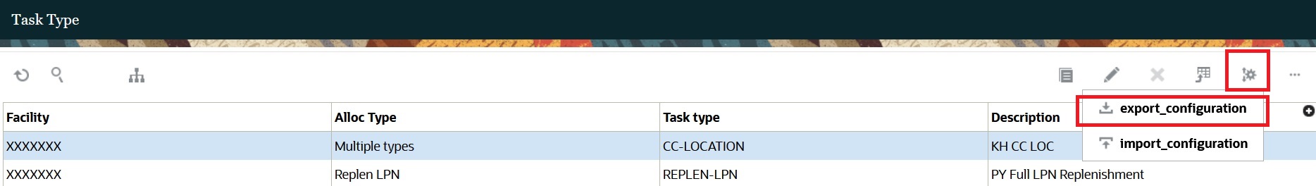

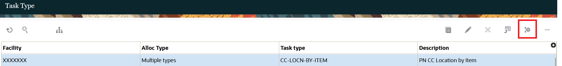

- On the right corner of the UI’s table, click “config” action button.
- In the drop-down options, click “export_configuration” option.
The system prompts to save the configuration file (.cfg file format) that needs to be downloaded in the local file system.
Note: You have to enable download permissions on your browser to download and save the export configuration file. - Select the folder location and click Save.
- In the drop-down options, click “import_configuration” option.
