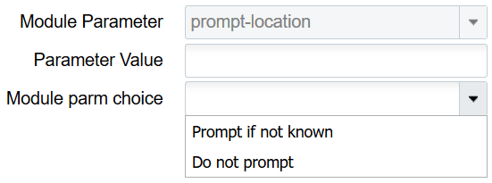

  3. Select the “prompt-location” parameter. Click Edit ().
  4. From the “Module parm choice” drop-down, select the desired option.
    Prompt-location Parameter
    The screen parameter “prompt-location” can be configured with one of the following options:
    • Prompt if not known: Location prompt will be displayed
    • Do not prompt: Location prompt will not be displayed
    • If this parameter is not configured, system will default to the behavior described for the option Prompt if not known above.
