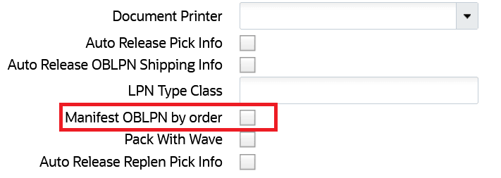

  • “Manifest OBLPN by order” in the Wave Template UI
    After enabling the flag, the system looks up the Ship Via for the OBLPNS allocated by the configured wave. The wave proceeds with the multi piece shipment flow if the Ship Via is configured with the “Multi Piece Shipment” flag.

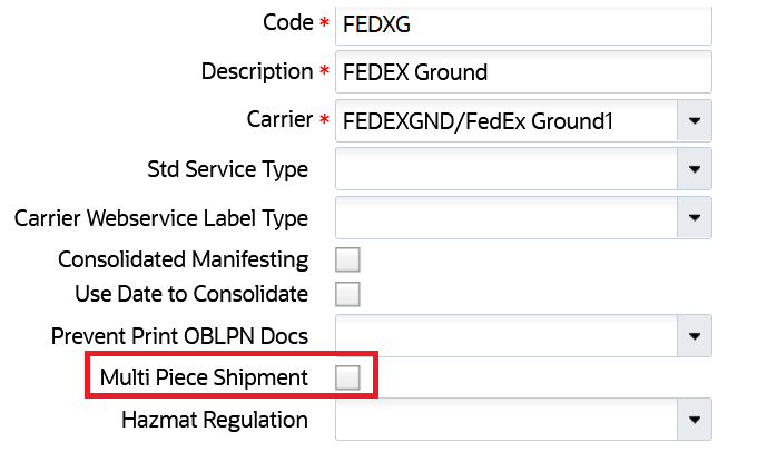

  • “Multi Piece Shipment” flag in the Ship Via UI
    After enabling the flag, the system will consider configuring the Ship Via for the MPS shipment.
    When you enable the “Multi piece Shipment” and “Manifest OBLPN by order” flags, the system groups the OBLPNs by Order Number for the ship via (Multi piece Shipment flag enabled) selected by the wave for multi-piece manifest.

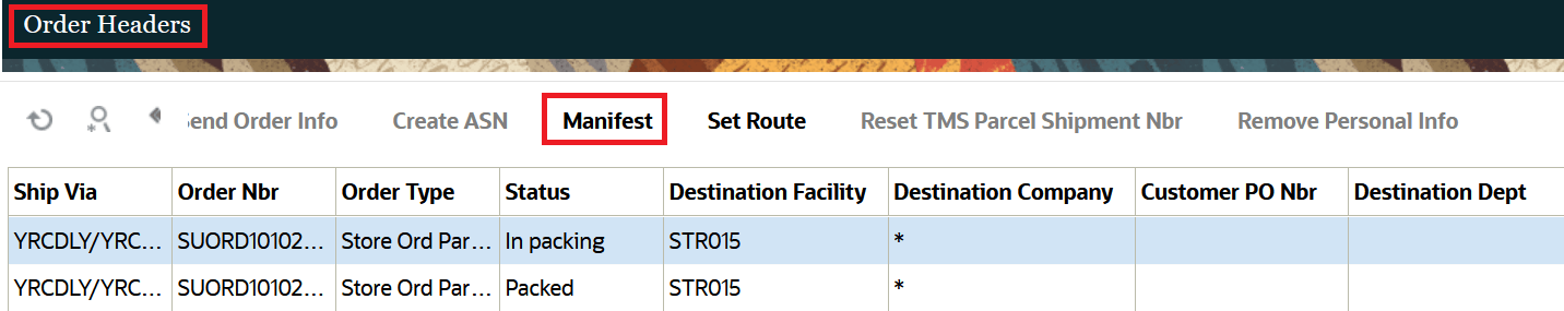

You can trigger an MPS request for all OBLPNs associated with an order on the Order Headers screen.
To manually trigger an MPS request, do the following:
  1. Go to Order Headers screen.
  2. Select an order record.
  3. Click the “Manifest” button.
    This manifests all OBLPNs for the selected order.
    Order Headers Manifest Button
