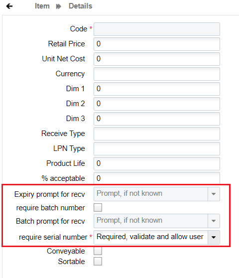

Item Level Configuration
An item level configuration provides you with an option for prompting the batch/expiry prompt, even if the batch/expiry is present on the shipment detail. You can also override the batch number/ expiry date during receiving, if shipment detail is defined with batch number and expiry date based on the prompt behavior.
You can define the Item level configuration provided via Item Details UI and Item Interface Input File.
The batch/expiry prompt during receiving configuration is supported via Receive lpn Shipment (rf.inbound.cwrfrecvlpnshpmt) and Receive lpn load (rf.inbound.cwrfrecvlpnload) screen.
Note: By default, the "Batch prompt for recv " and "Expiry prompt for recv " fields are set to “Prompt, if not known” value for all the existing and new items. These configurations are applicable only for batch/expiry tracked items. For all the non-batch/expiry tracked items, these fields are disabled.
