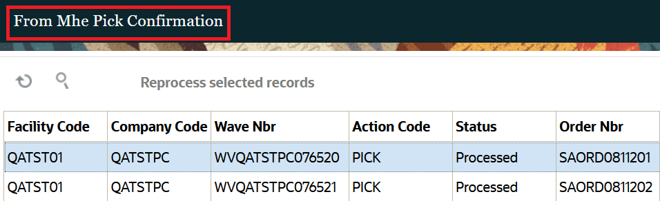

From the From MHE Pick Confirmation UI, you can see the pick confirmation messages flowing in to WMS and track MHE picking:
Reprocess Failed Records from the MHE Pick Confirmation UI
Oracle WMS Cloud lets you reprocess failed records from the MHE Pick Confirmation screen so that they do not have to send the pick confirmation messages once again from the MHE itself. MHE systems (Pick to Light systems, ASRS systems or external applications) currently send picking information to the WMS through the lgfpickconfirmation API.
When messages are sent to the WMS from the API – after basic validations of the data elements are carried out – you can see the messages through the From MHE Pick Confirmation View module. If the processing of the record fails, the message is flagged with status of "Failed." Once the messages are marked as failed, there is no way for you to reprocess the messages. You can use the option to reprocess a failed record in MHE Pick Confirmation screen via the action button "Reprocess Selected Records" so that the pick confirmation messages need not be sent again from the MHE.
  • Select the "Reprocess Selected Records" action button and submit the message for reprocessing for messages in "Failed" status only. Disable the action button if status of the message is other than "Failed".
  • Once the message is submitted for reprocessing its status will change to "Processing."
  • You will be able to multi select records in "Failed" status and submit for processing. If any of the messages selected do not have "Failed" status, then, do not enable the action button.
  • Submitting for reprocessing will invoke the relevant pick confirmation message for normal validation as before.
  • If you select record/s for reprocess with the action code of "Complete" for Reprocessing and if there are other records of action code "Pick"/"Short"/"Close" for the same wave number in status "Ready", then, the system displays the error message "Other messages for same wave number present."
  • If you select record/s for reprocess with action code of "Close" for Reprocessing and if there are other records of action code "Pick" for the same wave number/OBLPN Number combination in status "Ready", then, the system displays the error message "Other messages for same wave number or OBLPN number present."
