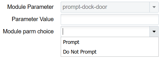

  2. Select the receiving module and click Details. This will display all the parameters for the selected module.
  3. Select the parameter “prompt-dock-door”. Click Edit.
From the “Module parm choice” drop-down, select the desired option.
Edit prompt-dock-door Parameter
You can configure the screen parameter “prompt-dock-door” with one of the following options:
  • Prompt: Dock door prompt is displayed. You have the option to either scan the dock door or skip it and directly enter the Shipment/Load nbr.
  • Do Not Prompt: Dock door prompt is not displayed. You are taken to the Shipment/Load prompt directly. The received LPNs remain in received status. However if the Shipment/Load was checked into a dock door before receiving, then the LPNs will be located to the dock door after receiving.
