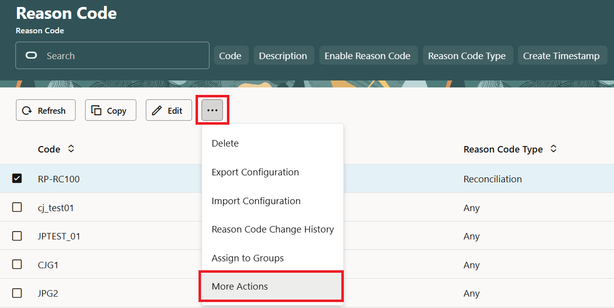

To support Reason Code Assignment to Groups, child screens are made available in the Reason Code View UI on the REDWOOD. To access these screens, you need to click following 3 buttons available in the More option:
  • Assign To Groups: Allows assignment of user groups to each reason code
  • Assign to Categories: Allows assignment of categories to each reason code
  • Reason Code Literals: Displays reason codes with supported translation.
    Reason Code Authorization
    • By default, these buttons are disabled. You need to select one or more records to enable the button and access the screen.
    • These buttons are permission controlled and requires “Reason Code / Edit Reason Code" to be enabled for non admin user.

To apply the reason code authorization, do the following:
  1. Launch Redwood Mobile Reason Code Transaction
  2. Select the one or multiple record.
  3. Click More Action (…) button. The Assign to Group and Assign to Category are enabled.
  4. Click your desired button and the child screen opens.
  5. Perform CRUD operations.

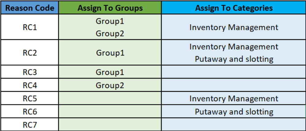

Example: UI Transaction Mobile Scenarios
If a reason code is assigned to a specific group and/or category, the system allows its use only for that group and/or for screens belonging to the specific category.
For example, let’s say you have the following reason code configuration.
Note: This logic applies for Mobile transaction scenarios as well.
Reason Code Authorization Transaction Logic
Case 1: If User1 of Group1 cancels an OB Order via OrderHdrView UI (Of 'Wave Management' category ), then, the Reason code drop-down list displays only - RC2, RC3, RC6, & RC7.
Case 2: If User2 of Group2 cancels an OB Order via OrderHdrView UI (Of 'Wave Management' category), then, the Reason code drop-down list displays only - RC4, RC6, & RC7.
Case 3: If User1 of Group1 modifies the LPN Quantity via IbContainerView UI (Of 'Inventory Management' category), then, the Reason code drop-down list displays only - RC1, RC2, RC3, RC5, & RC7.
Note: If a user is assigned to multiple groups, the Reason code Authorization Logic is validated against the logged-in view/group.
