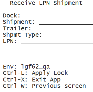

  1. Go to the “Receive LPN Shipment” module.
    Receive LPN Shipment RF Module
  2. If the ASN’s Load Number is checked into a dock, scan the dock number. Otherwise, skip the “Dock” field by pressing Tab.
    1. If the Dock is scanned, the system will automatically populate the ASN in that dock.
    2. If the trailer number is included in the ASN record, it will automatically be populated.
    3. If this field is blank, skip it by pressing Tab.Dock with ASN Populated
