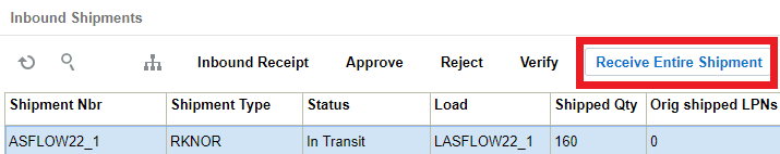

  1. Go to the “Inbound Shipments” screen, select the ASN and click “Receive Entire Shipment”.
    Note: Ensure the ASN is cartonized prior to receiving the entire ASN.
    Using the "Receive Entire Shipment button
