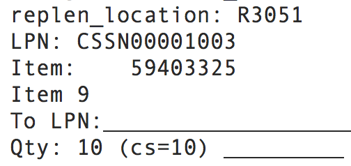

  2. Once the location barcode is scanned, the RF will ask you to scan the “To LPN” (the destination pallet). This is the LPN that is replenished. In the “Qty:” field, you must enter the amount of cases being moved.
    scanning the LPN details
    Note: for the “Qty: 10 (cs=10)”, the first 10 represents the number of cases to move, while the second “10” value (“cs=10”) represents the standard case quantity of the item.
