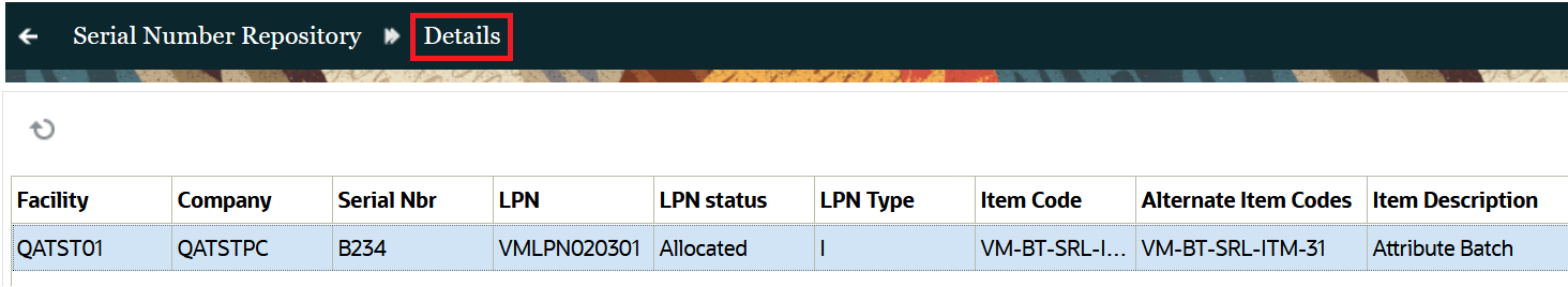

You can also drill down to the serial number record’s details to view the inventory associated to it:
serial number repository details
If the serial number is associated to inventory, the detailed view indicates the LPN’s status (Located, Allocated, Packed, and so on).
