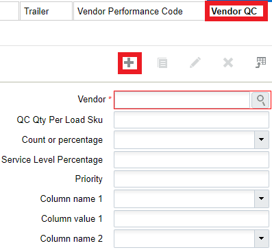

  5. For each Vendor that requires QC validations, create a new record by clicking the Create button ().
  6. For each Vendor QC record, populate the following fields:
    Adding a new Vendor for QC
    1. Vendor: Populate the Vendor that will be used for QC. Use the magnifying glass to display a list of Vendors currently in the system.
    2. QC Qty Per Load SKU: Enter a value that will be checked for QC.
    3. Count or percentage: Enter a “U” for count and “P” for percentage.
    4. Service Level Percentage: Also known as ‘Reception Percent Level’, this parameter is used for advanced LPN distribution to ensure the inventory is evenly distributed to multiple stores.
    5. Column_Name_1: Users will be presented with the following columns for configuring additional filter criteria:
      • Shipment.Shipment Type
      • Item.Putaway Type
      • Item Facility.Putaway Type
      • Item.Group Code
      • Vendor.Custom_Field_1 to 5
    6. Column_value_1: Comparison value for the selected column in column_name_1. If no value is provided, the system will search for the corresponding column_name_1 with value =blank
    7. Column_Name_2: Users will be presented with the following columns for configuring additional filter criteria:
      • Item.Putaway Type
      • Item.Group Code
    8. Column_value_2: Comparison value for the selected column in column_name_1. If no value is provided, the system will search for the corresponding column_name_1 with value =blank.
  7. Click ‘Save’.

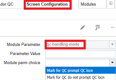

  8. Configure the modules that will be used in QC. First, enable the receiving module to recognize LPNs for QC.
    1. From the ‘Screen Configuration’ screen, select a receiving module that will capture QC and click on Details.
    2. If you have a Quality Control location, set the Module Parameter ‘qc_handling_mode’ to ‘Mark for QC prompt QC locn’. If you do not have a Quality Control location, select the parameter and click the ‘Edit’ button in order to update this parameter.
      Enabling the QC check in the Receiving module
    3. Click “Save”.

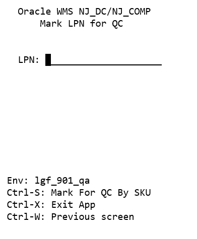

  9. The Mark LPN for QC transaction allows you to randomly select LPNs from a shipment to be marked for quality control. You can use Mark LPN for QC for cartonized shipments, and users/supervisors can select the LPNs that they would like to designate for QC.
    Mark LPN for QC
    If you need to do quality control for all of the inventory for a specific SKU, select the hot key Ctrl-S. Ctrl-S will mark the shipment detail for quality control. Once you select Ctrl-S, the Mark SKU for QC screen displays:
    Mark SKU for QC
    The Mark SKU for QC transaction does not support scanning an LPN which has already been received. If the LPN has already been marked for QC, the LPN is part of a shipment, and the status is Verified, the error “Scanned LPN is not valid for QC” displays.
    If the LPN meets the criteria, the system displays the message “LPN% marked for QC”. The marked for qc flag on the inbound shipment detail for the corresponding LPN will be set to yes.
    LPNs or inventory designated for QC will be marked “Yes” on the marked for qc flag in the Inbound Shipment detail.

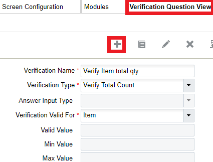

  10. You can use the Verification Questions UI to set up Verification questions to use during QC Complete.
    Fields Description
    Verification Name What you want to call your verification questions.
    Verification Type Allows you to verify total count, standard case, standard pack, or user-defined verification question.
    Answer Input Type Allows you to set the answer input type. The Answer Input Type options include the following:
    • Yes/NO
    • Text
    • Date
    • Decimal
    • Integer
    • Yes
    Verification Valid From Can be for Item or LPN.
    Valid Value Allows you to specify valid value.
    Min Value Allows you to specify minimum value.
    Max Value Allows you to specify maximum value.

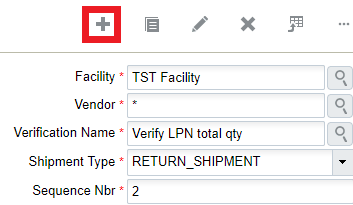

  11. The verification question must be assigned to a vendor in order for the right questions to be asked during QC confirmation.
    Next, go to the Verification Question Configuration UI and click Create to set up the Verification Question Configuration.
    You can associate questions to the following items:
    • Facility Type
    • Vendor Type
    • Verification Name
    • Shipment Type
    • Sequence Number
    Questions will be displayed in the sequence set up in this screen.

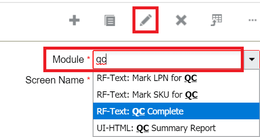

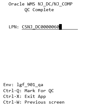

  12. Configure the module for processing the LPNs for QC.
    1. Go to the ‘Screen Configuration’ screen.
    2. Add a new screen with the Create button ().
      QC Complete
    3. Add this new screen to the appropriate Menu.
      QC Complete
      Parameters Description
      qty-entry-mode None/Sku-Qty/Sku-Scan
      qty-uom None/Units/Packs/Cases
      distribute-lpn-transaction Valid Transaction name to call distribute LPN when QC passes or the LPN is accepted
      prompt-vendorperf-code None/No/Yes

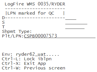

  1. During receiving, if the user receives an ASN from a Vendor that was flagged for QC, the LPN will be marked for QC. This is system driven, so the user will receive a message. Press Ctrl-A to proceed:
    Receiving with a QC Vendor

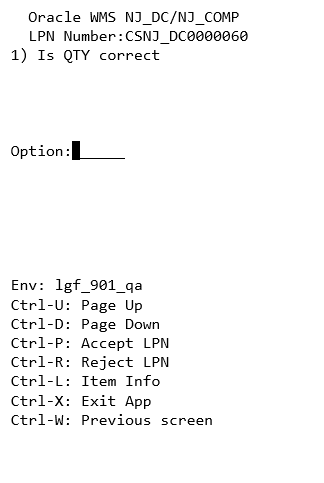

  1. Enter the “Process QC” module.
  2. Scan the LPN that will be processed for QC.
    LPN to be processed for QC
    User can make use of the control options to approve or reject LPNs.
  3. Press Ctrl-P to mark the LPN to be ready for QC:
    Approve/Reject LPN
    You can answer all of the questions set up in the verification question view, and also use the control options to approve or reject LPNs.
  4. Press Ctrl-P to approve and Ctrl-R to reject.
    1. If the user enters Ctrl-R to REJECT, the system will display a confirmation message. Press Ctrl-A to proceed.
    2. If the user enters Ctrl-P to APPROVE, the system will display a confirmation message. Press Ctrl-A to proceed.

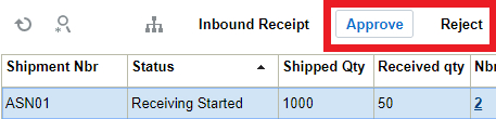

  1. From the Inbound Shipments screen, select the ASN with QC LPNs.
  2. Click either “Approve” or “Reject.” This will affect ALL QC LPNs in the shipment.
    Select Approve or Reject

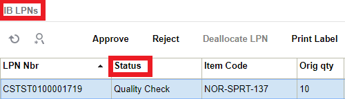

  3. From the IBLPN screen, select the IBLPN that is in “Quality Check” status.
  4. Click either “Approve” or “Reject” to process it.
    IBLPN in Quality Check Status
